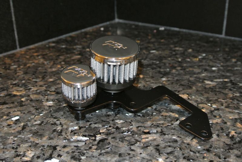

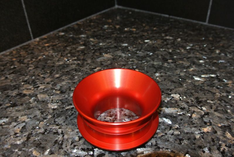

I purchased a Corse Dynamics velocity stack kit for my EVO SP and thought I would share my experience installing it as well as a review of the differences in performance.
The Corse Dynamics kit is a complete kit. One of the things that sold me about it was the bracket that holds the rear coil and has provisions for both the crankcase breather and idle air filter. To me it is a nice all in one unit that allows for a clean setup underneath the seat. Brackets that hold the front coil to the frame were included as well.
My intentions for installing the stacks were to allow the bike to breath as well as it could in order to accompany the full exhaust and let's be honest, there's really nothing sexy about a bulky airbox on something like this. I wasn't planning on doing this for a while but the kit was on sale and due to the off season, I thought it would be a great little winter project. The longest part was waiting for parts to arrive thanks to drop shipping and places that indicated they had the parts in stock, ready to ship, but really didn't... but I won't go into that here.
This thread here, among others, was especially helpful and a real confidence booster for me before I set out to take the bike apart which I will admit was a bit nerve racking at first because I had never torn a Ducati apart. There were however a couple of very small variations that differed from what the general instructions were but not a big deal and it may be related to it being an EVO, I'm guessing, and has some very slight differences here and there.
1. Instead of having both nipples on the bottom of the air box that simply pulled out of the frame, mine had a screw on the bottom of one that would've been very inconvenient if it had stripped.
2. The idle air breather tube is the same size as the large crankcase breather hose on mine. From what I've seen in all the photos, the idle air tube is smaller, hence the reason for the miniature filter that comes with the kits. Because of this, I had to run an adapter in order to still retain the use of the small filter the bracket is designed for. Again, I'm guessing these minor differences are due to it being an EVO motor and most of the threads and installation info here are in regards to pre 2010 bikes. On a side note, I did not cut either of the hoses and left everything the same length.
Overall, I was impressed with the quality of the all the parts and would recommend the kit 100%. The components are not an embarrassment or understatement to the rest of the bike but I did make a little change and that was to the pod filters. To be frank, I have never really been a fan of K&N filters and it's just a personal preference thing about them. I decided to research what options there were out there for a foam clamp on pod style filter of the same nature and Uni had such thing, only the flange was a bit bigger along with the outside diameter. They had no problem clamping down on the stacks however to make a tight seal. I did not think the left side inner filter was going to fit at first but with some patience, it slipped in and both sit next to each other with no clearance issues from the tank.

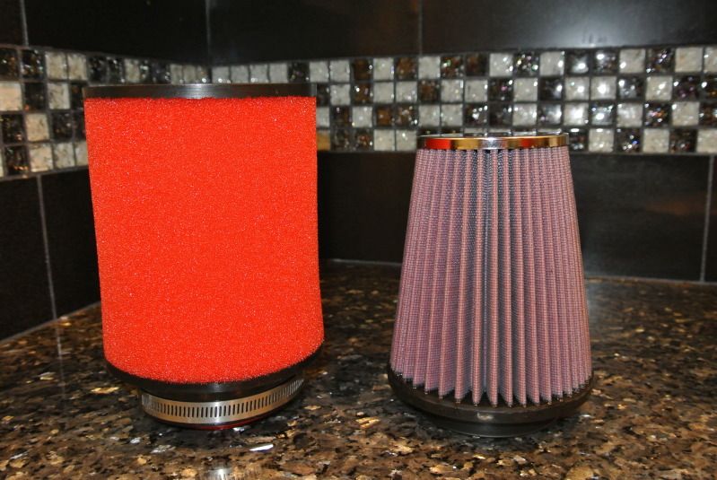

Good write up, thanks for taking the time. I suppose your filters will do better with our weather up here? I had to run pre-filters quite a bit during the spring months to keep the k&n's from drowning. I love listening to the induction noise as I am blasting around the track, its quite the thing.

Yeah, foam filters do tend to be more water repellant, especially when they are oiled. I agree 100% with the sound. There is nothing like it and is pure orchestra for me. :)

The UNI filters that I used are part #: UP6350ST. If you do go that route, just keep in mind the left side takes a lot of patience to squeeze in, but it will go. :cool:

So after a while of calling and mailing with a manufacturer of foam filters in the UK I was able to get them to make custom foam filters with my specs. At first I thought costs would skyrocket since it's a custom job, but it would cost the same as the Uni filters with the too big ID.
Better yet, the specs are pretty close to the K&N pods. For future reference and anyone using the search in the future, here are the specs for the filters I'm having manufactured:
Neck ID: 82mm (this will clamp down fine to 80mm)
Outside Base Diameter: 122mm
Top Diameter: 90mm
Filter body height: 152mm
Neck: 25mm
If all goes well, they should arrive by the end of next week. Can't wait to see if these improve the performance or not.
