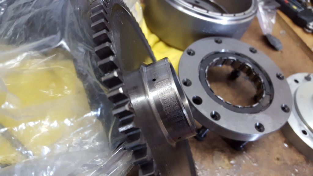

RockAZ, if you absolutely have to ride the bike if the sprag doesn't catch try rotating the rear wheel forward in gear. I had the sprag fail to catch this fall on the day I was supposed to take the bike out for a run with some friends. It caught, let go. Caught, let go again, then it just spun. Tossed it in first, spun the motor over using the rear wheel about a half rotation and then tried again and it caught.
Just note, the longer you try to start it with a bad sprag the more you're gonna chew up the flange and the bearing race on the big gear. That's what happened to me. Sprag was crap in the motor when I got it but it would always eventually catch. Well my last oil change revealed a pile of very fine steel particles, and when I pulled the big gear the race surface was pitted and ground up as was the contact surfaces on the sprag.
Not cool lol. I bought a good second hand gear and flange on the cheap to replace them. Just note you should check everything over especially if it's been failing for a while.
