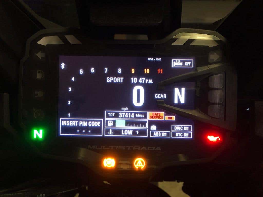

Hi guys, is there a way to reset the service date on the display? Also, what is the red and black picture right next to the service date?
Thank you very much
