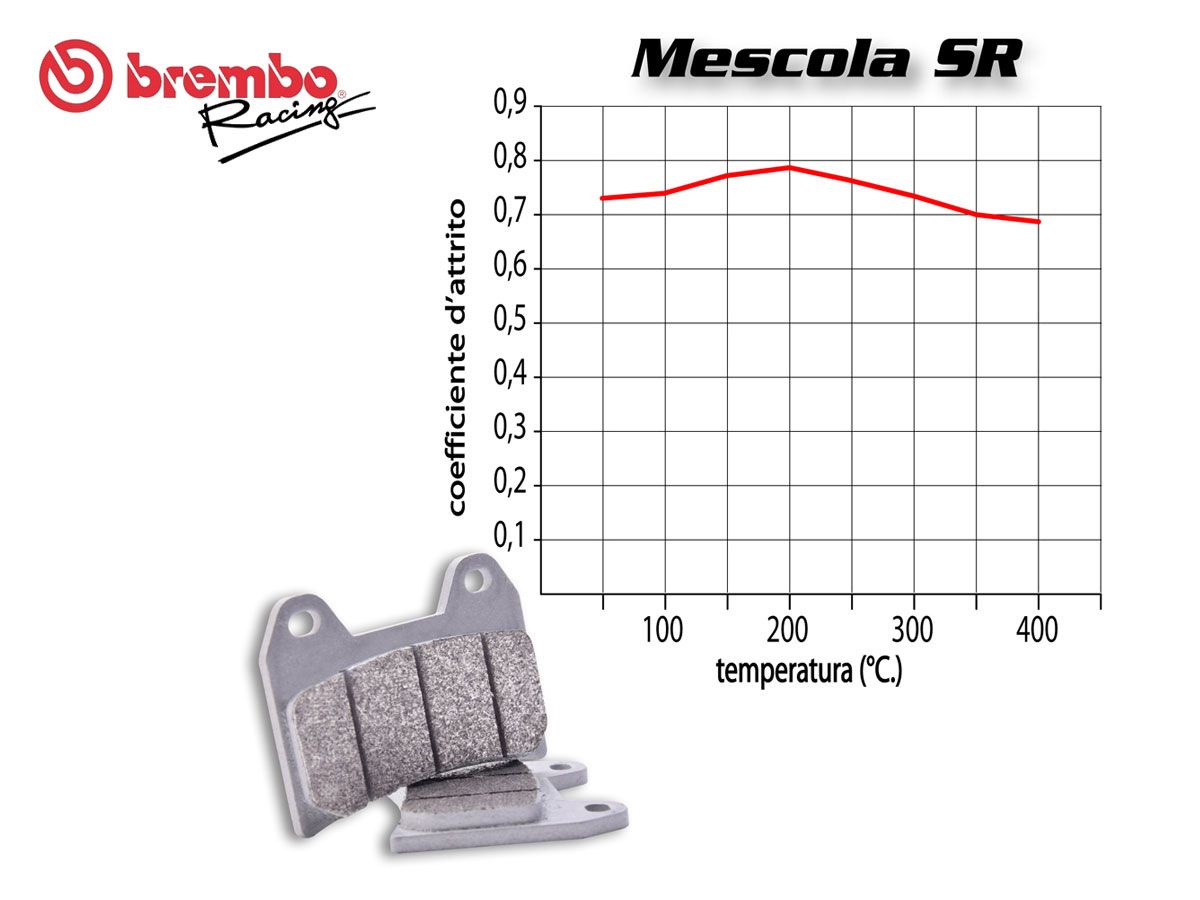

Gday, I have a 2021 V4s sport and want to try different brake pads. Stock ones are (61341341A) I only ride on the road at a moderate to fast pace. I know that my bike has M50 brembo calipers that are shared with the PP version and several other bikes. Panigale etc. So I assume any brake pads that fit them would fit mine.
The PP brake caliper part number is 61341271A. Does anyone know what the corresponding Brembo part number is? Is this a SA compound brake pad? The closest I can tell is the Brembo 07BB37SA pad. When searching Ducati part numbers is doesn't really give you much info about the actual compound of the brake itself. Then when searching Brembo website my bike doesnt come up.
Any info would be appreciated.

I had a look at the Z04's which are a race pad. The problem is that the pads don't work well unless they are hot. You can't build enough temp into them on the road.
Here's a link about the different Brembo brake compounds. After watching this Im going to try the 07BB37SA compound , which are coloured red.
The video has part numbers for the 2012-2014 multistrada, but the bit Im interested in is the letter after it. LA, SA, SC, SR. all front pads which fit V4s are 07BB37 followed by the two letters.

Hi Jonny,
I used to think my Multistrada V4S had decent (front) brakes until I bought my KTM Super Duke 1390R Evo. Granted the Ducati has an extra 100 pounds compared to the KTM, but there is a noticeable difference in initial grab (lacking) and full stop. I tried EBC green pads and they don't perform as well as the stock Brembo's. You mentioned that you went with Brembo sintered racing pads (P/N 07BB37SR) and were happy with those. Are you still happy with them or considering other options next time?
