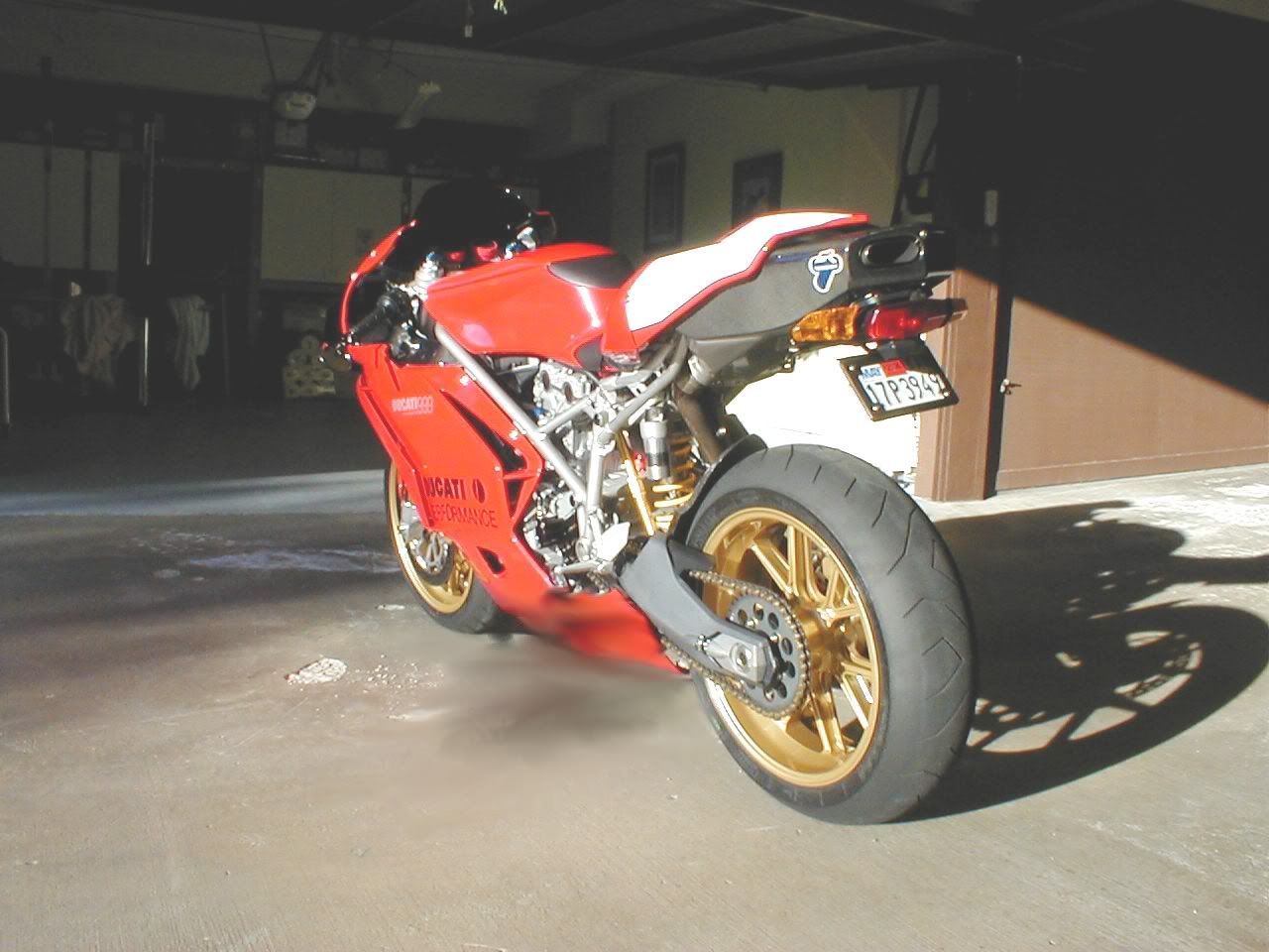

I had the same questions when upgrading to Forged Marchesinis in December, what size rear tire? I have a 2004 999 and installed a 6" rear wheel. I always thought the OEM Michelin 190X55 looked like a misfit and the bike never turned in properly even with the standard suspension changes recommended by Section 8 and others.
I ended up with a 180X55 Pirelli Supercorsa rear on the 6" rim. I was very skeptical because of what I had read on various forums re; tire vs. rim size. Bottom line, I love the way the bike handles with the Pirellis. The profile works great allowing the bike to tip in to it's lean potential rather than drop in to a certain point and then trying to "pull" it over further. BTW, the Pirelli tire chart recommends the 180X55 for a 6" rim, same height as their 190X55. I know Michelin doesn't so check with the individual manufacturer.[jpg.
