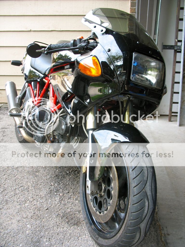

I just picked up a new to me '92 900 ss. Love the bike, the previous owner put some JE high comp pistons, Staintune headers, Feracci carbon pipes etc on her.
I just had the valves done, and changed the blets, plugs, engine oil, brake and clutch fluid too.
I'm wanting to put some new rubber on my fine lady, the current tires are old and dry. I'm wanting something that will last(dual compound ?) and will not break the bank. My wheels are stock as well.
FYI, I work at a motorcycle dealership ( not Duc though) and I can get "hook-ups" as far as discounts.
So guys, what is the hot set up and sizes ?
Thanks in advance for your advise.
Lucas

I figured someone might assume it was a CR because it has a 1/2 fairing. However, it has an aluminum swingarm, which was for the 5.5" wheel. Ducati did not make CRs in 1992. According to Ian Falloon, they were introduced in the U.S. in 1994 ;).
