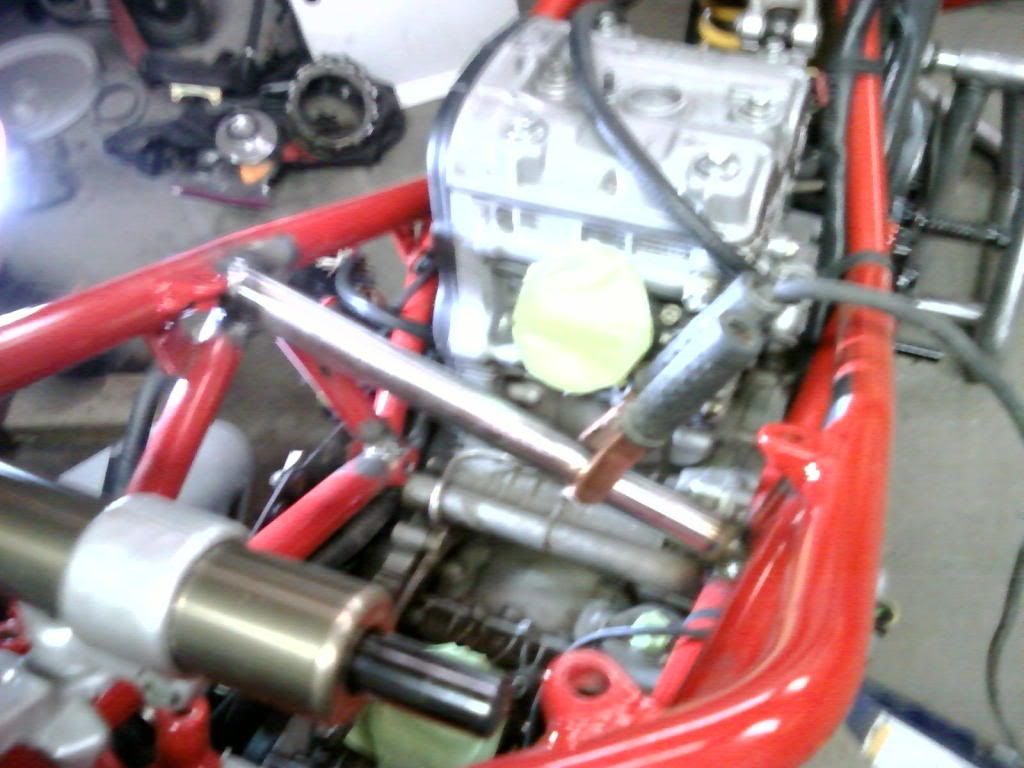

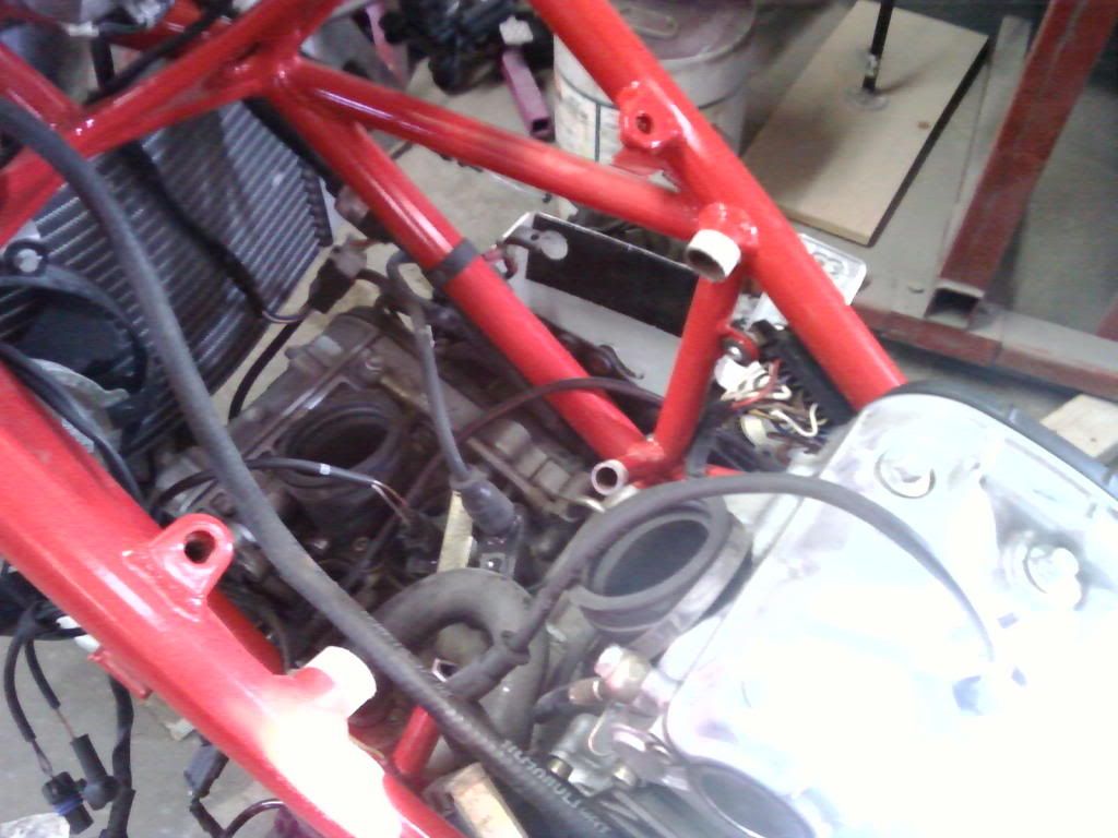

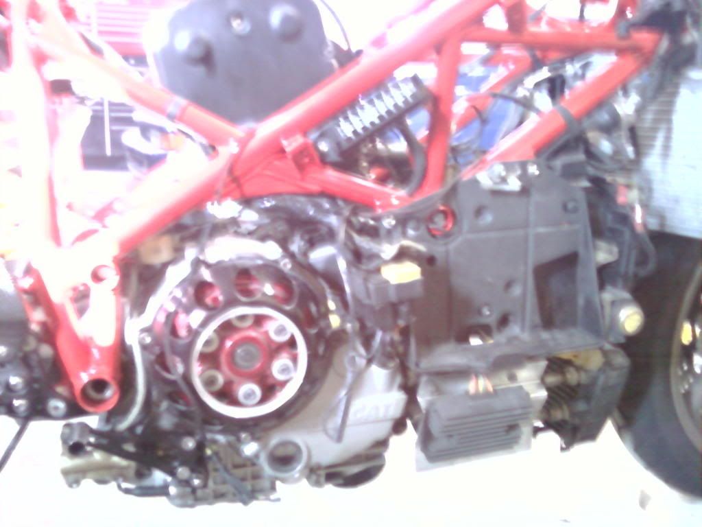

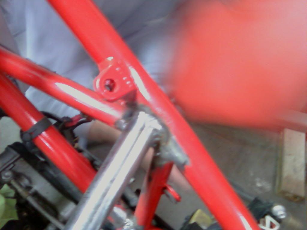

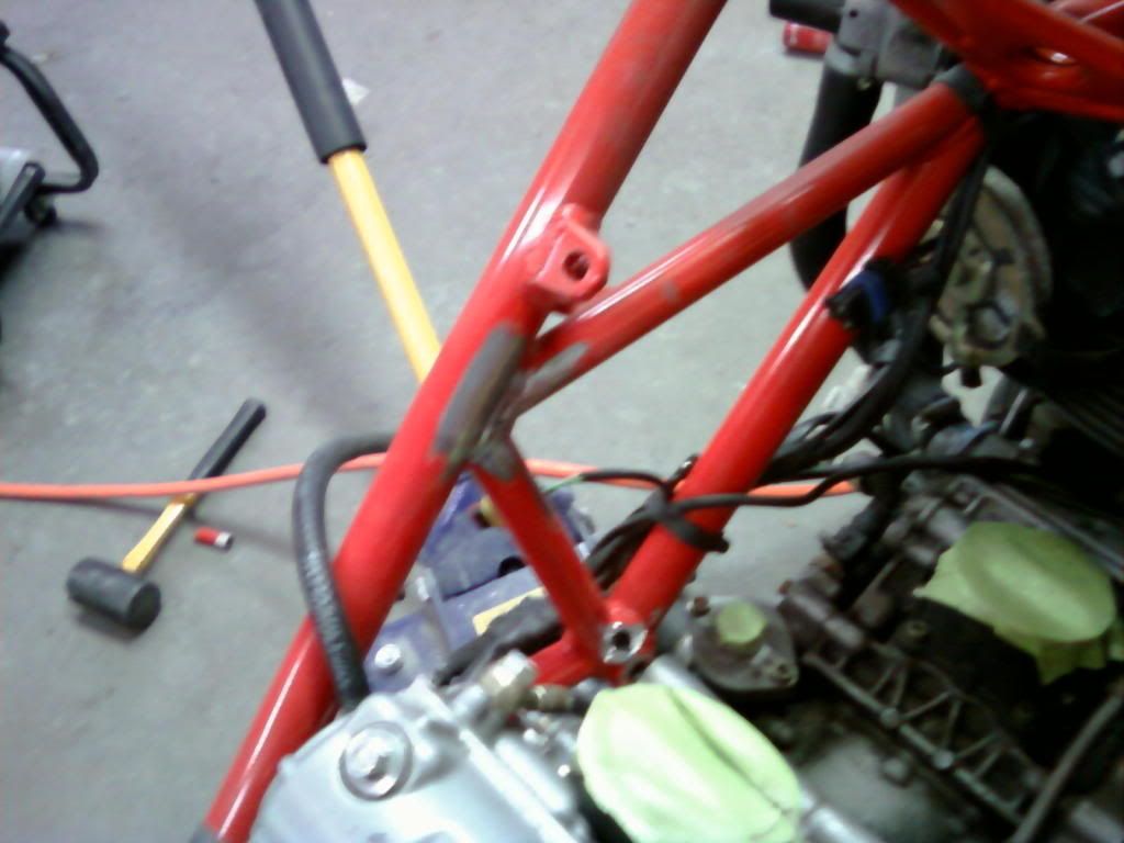

ok people wanna see , so heres pics....i could do a write up but today is my lazy day so ill answer questions as they come....the pics are low quality but you get the idea....enjoy. theres also random pics of the shift light and evoluzione ignition enhancer and other stuff mixed in....its also in no order

if a few people wanted to really know in depth id do one...how ever its not very plug and play once you get to the cutting of the stock brace , replacing it with a 999 style. and molding a 999 lower airbox to a 748 upper....
you can do this swap much easier if you use a 998 airbox and tbs ...then you just need a 998 harness and ecu. i did mine the hard way on purpose.
