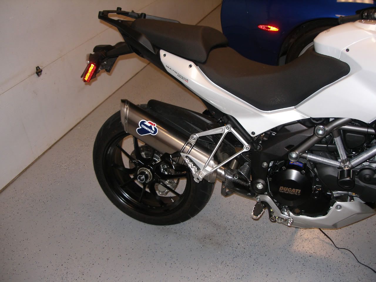

So I had eye surgery Friday and can't ride for a week so took the time to finally put on my full Termi exhaust. Ended up going in very easily and was a pretty nice kit. Some of the details could have been a bit better, there where some pieces that where mentioned nowhere in the instructions and also they changed how the carbon fiber piece is mounted from the instructions to the actual parts they give you. Not hard to figure out though.
The carbon piece doesn't flow very well and actually had a seam in it but other than that seems to be ok. I can't ride it for at least another couple days but started it and wow does it sound mean without the db killer in. Just fantastic. Might be too loud though to drive. Gonna scare all the Prius drivers around here :D. Will have to see. Here is the final look:
