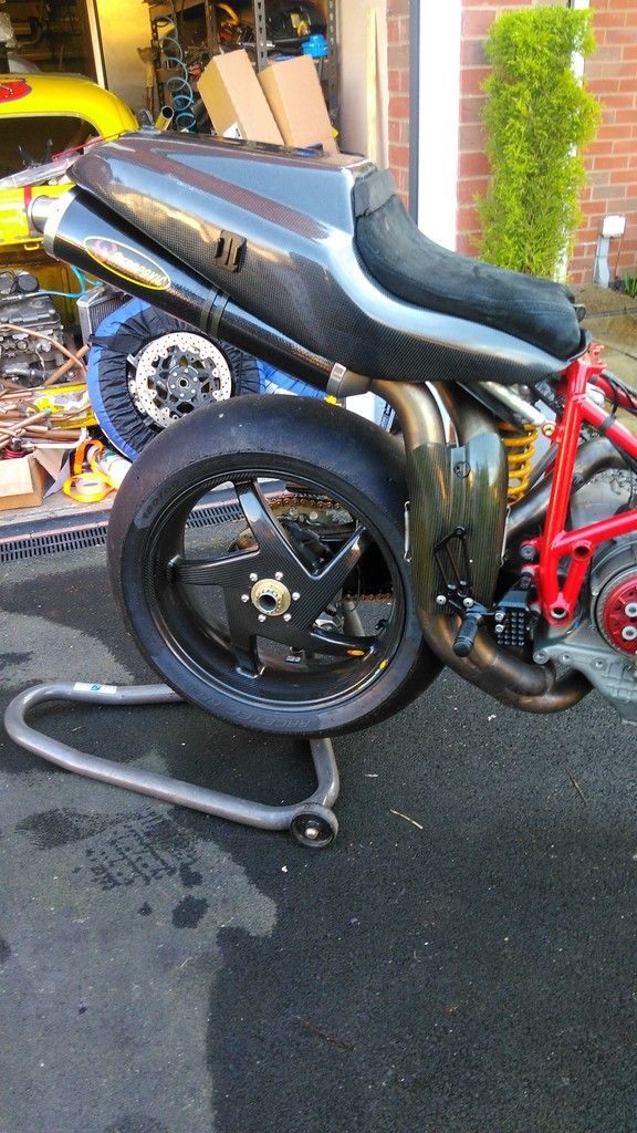

Morning all, I am wondering whether a 20mm longer swingarm is worth all the hassle? I mainly want to do this to reduce front lift off and yes I have played around with ride heights etc but it still annoys me. Having to rear brake to keep ti down...
SO is it worth it and what is the best / affordable method to do this e.g. multistrada swingarm on it's own?

I think I might try to lengthen the chain, I might have gone a link or two too short. RE stacks that would be hard as my airbox is so well made by myself I would have to angle grind the others off to fit new ones :)
· Registered
2,386 Posts
I put the 848 swing arm on my 998 for extra length, I added a link to my chain on 996 track bike to adjust the chain farther back.
