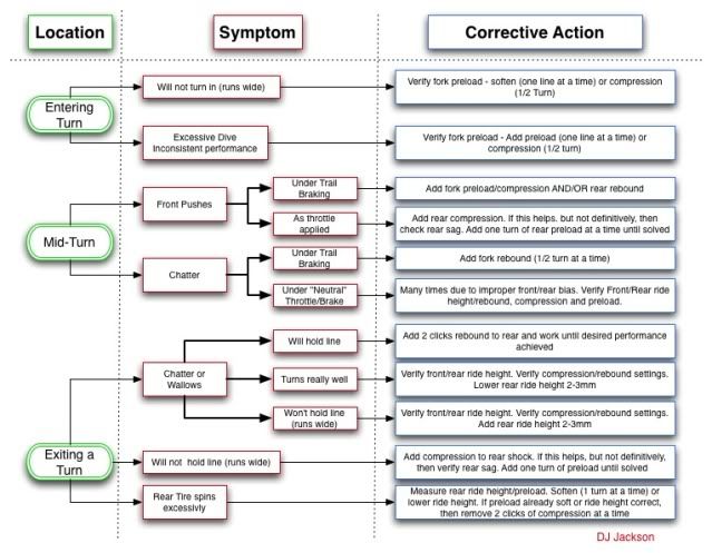

Can someone explain what the hell is 'Chatter'? Wallows? Spits or Wallows?? :eek:
I get most of this...but this one is a word from the klingon dictionary i am unfamiliar with :confused:
1,081 Posts
Ahhh the constant search for the holy grail of suspension.
I would say chatter is quick harsh movements.
Wallow would be a slow undulating sensation.

Do you have a larger / clearer copy of the flowchart image? Or a link where it can be found?
It looks like very good information.

Haha, yeah it's a nice little find i thought... There's some nice info on that site :)
