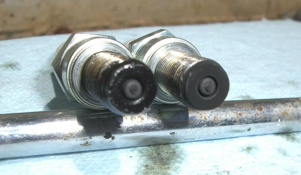

Ok, this may have caused my starting problems, anyone know how whay or why this would be all over this plug?
Just over 3k miles on bike........
Oh, and no, when it did run last it did not blow smoke, well, it blew carbin out but not blue smoke...
Had done a fresh oil change on it about 8 months ago, and couldnt get it to start after that, but was having starting issues prior...

First thing I'd do is put a set of normal plugs in it. Never liked those marine style plugs personally. A set of normally gapped standard NGKs would be a better choice to start. Might even try a set of NGK Iridium plugs gapped at .40". Cheaper to try standard plugs first.
BTW, you're not the first person I've seen using marine plugs in a bike. What is the perceived benefit??? Can’t be anti fouling... The arc over voltage would have to be huge to make that jump. Maybe your coil packs are damaged now and the voltage is arcing to ground in there instead of trying to make that huge gap at the plug.

Those plugs Champion RG59V were made Specifically for the 999R its OEM. Believe me I wouldn’t go out and buy something like this, I totally agree with you on the spark…. It may have to do with clearance. I have read multiple post on this but never really have heard someone that owns an R actually post how it went when they used something other than the OEM plug
From personal experience, I would highly recommend that you do NOT use anything other than the recommended surface discharge spark plugs.
During a prior service, a dealership(?) had put standard plugs in my 2004 749S. Bad move. The engine was specifically designed to use the surface discharge type plugs for a reason. At a subsequent servicing at another Ducati dealer, the tech pulled out the plugs and found both side electrodes broken off. Amazing the bike ran at all. Seems the tolerances are little tighter on the S and R 749 motors (which both use the surface discharge plugs). I would suspect the 999 is similar.
Use the recommended plugs.

Looks like oil seeping past the gasket. Is there any oil residue at the bottom of the spark plug well?
Should be surgically clean and DRY of oil.
I think the reason Duc used surface discharge plugs was due to combustion chamber swirl and flow characteristics. No plug to get in the way of the flame-front hence faster and more complete burn.
It is tough to get a combustion chamber that big to burn fast enough without resorting to a 2 plug setup.
Check that gasket!

I will have to check the receipt that I recently found on the 600 mile service I had done. I cant remember everything they did but it probably did include pulling the covers off to check valves. Im sure they didnt use new gaskets, and I know I was charged a lot of money. That place has since went bankrupt and closed their doors, lol
