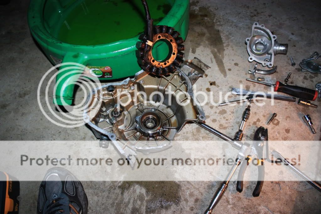

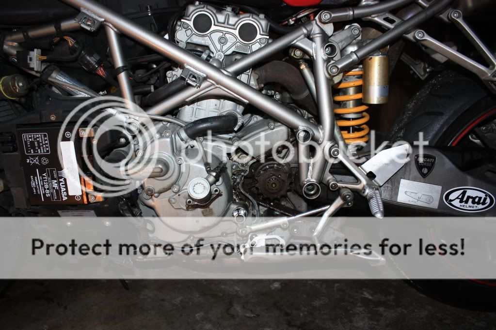

So today after a little over an hour of cruzin palomar my bad luck finally caught up to me. I passed (was let by, by the driver) a suv and was followed by an 848. After passing I accelerated into the turn then came out clean. During the next set of turns 3/4s near the top I lost all power and the RPM dropped to 0. During the straight the 848 passed me and told me I was leaking oil. I already had the clutch in so i coasted to a safe(er) clear spot and stopped. Upon dismount I discovered to my horror that I was pretty much boned.
fast forward a few hours and this is where I'm at now.

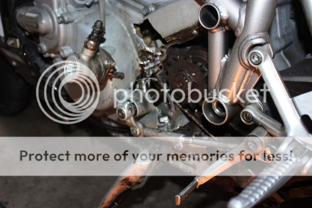

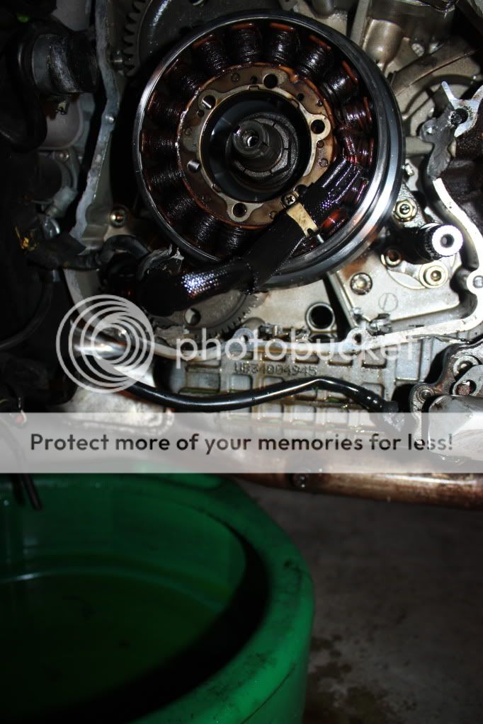

Heres a few more
So all hope has been dashed. I'd hoped it was just the L.S. cover but a small 1.5" long section has been removed from the engine case. So i guess its trash as far as I know cast aluminum cannot be welded. If any one has or knows of any on the stuff I require for sale shoot me a message. I guess the VFR is for sale now... :(
