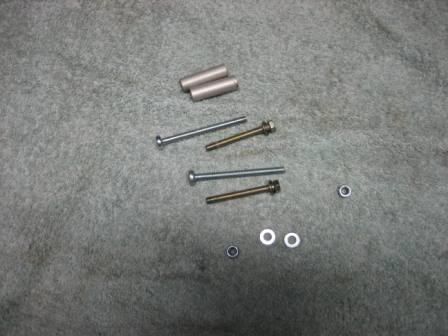

It seems like there’s always a reason to take the side panels off my bike. It’s either general maintenance, install/removal of pannier brackets or something. It’s really a fairly simple job except I have problems getting the front bolt and spacer lined up and started straight. To make matters worse, the rear shock reservoir is in the way on the right, and I have a Motobags frame bag on the left which makes that side especially tricky.
So, I came up with this easy fix and thought I’d pass it along. I bought a couple of M5x.80 x 60mm long bolts with washers and nylon locking nuts to match. The photo below shows these as well as the factory bolts (gold anodized) and the spacers.
I just cut the heads off the bolts, added a drop of Loc-tite and threaded them into the recessed nuts on the fairings.
Then, I put a little silicon on the stud to secure the spacer and let everything dry.
It makes bolting the front of the fairings on a snap. All in all, it probably only knocked a few minutes off reassembly, but it’s the little things, right? :)

Great idea. You have no idea how many times I've bitched about the stock setup!

Considering that the mount for the brass insert in one of mine cracked and had to be epoxied back together, I think this is a brilliant move!

I've got a broken one too. I used JB Weld and clamped it in place with wire.

Many moons ago in the days of the old ST4S.COM the owner of the site recommended this mod and it is a good one. I use wing nuts and they hold well too

That is a great mod. I will have my side panels off this week doing track prep- I'll do this while they are off the bike.
