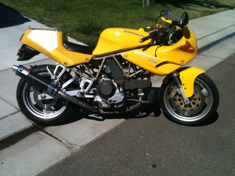

I recently bought a 1997 900SS and am reviving it after 7 years of sitting in a garage. I have replaced the battery, Changed the oil, replaced the fluid in the brakes and gave it a quick once over. The Clutch is flat...does nothing when you squeeze the handle. I tried to change the fluid and bleed it but still nothing. I decided to fire it up after draining all the fuel and filling it with new fuel. It will fire for a couple seconds with the choke on fully but will not stay running. Where do I start? How tough is it to rebuild the carbs? Could the brake master cylinder have went bad from sitting? Any input would be appreciated. Thanks, Rick.

very nice looking bike; the rack on the rear seat unit is an interesting touch too, but I think you'll find it's not a '97 (manufactured) model as there isn't an oil temp gauge or underslung rear brake caliper, more likely to be a '95.
You are right. I bought the bike with the previous owner stating it was a 1997. The year it was built was 95 but first sold in 97. I discovered this last night. The rack is interesting isn't it......that was the only thing I don't like about the bike. I am going to talk to a friend of mine to see how much to cover the holes and repaint the tail section.

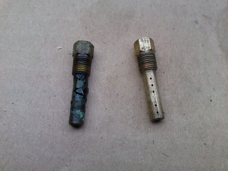

Your carbs will be full of seven-year old fuel. I rescued a CBR6 from its six-year garage hibernation & the fuel that was in the tank was - I kid you not - neon green & fkn STANK! I left the tap & cap off for it to vent a while but had to move the tank from the garage to the shed as the fumes gave me a headache...
Here are the emulsion tubes...
(akkkkk) :eek: Ikky! No brake or carb cleaner would touch this crap - in the end I LIGHTLY blowtorched them, all the gak turned to ash & brushed off real easy! ;) Get the worst of the crap off by scraping it with a brass scraper - or a screwdriver with the corners rounded?
