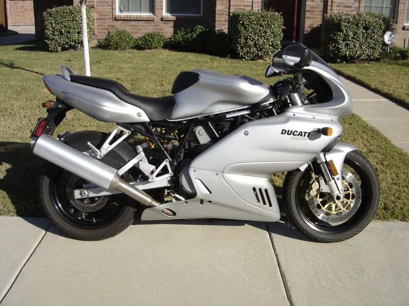

I used a caliper paint kit that I got at the autoparts store. Got many compliments on it at Bike Week.
Stock (sorry, no close up)
After, with paint job:
