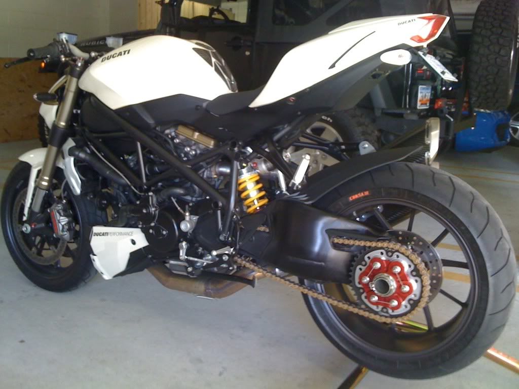

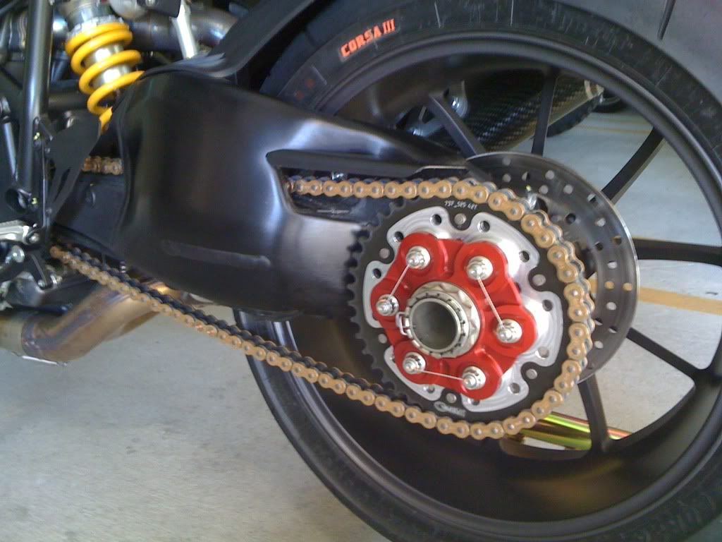

My Sunday afternoon project. Went to a 42T Supersprox and MW hub cover. Way more pull and a useable 6th gear. Ready for someone make an ECU that is dyno'able, (Nemesis, Microtec, etc.) so the bottom end will run as well as the top end. Anyone heard any more on ECU's available for the Streetfighter?
427 Posts
oooohhh... very nice! Did you install a new chain as well... do you need to do a new chain with the added diameter of a bigger sprocket?
I also like the tail tidy look and the tank protector... very nice!

Yup, had to get a new/longer chain, think it ended up being 2 or 3 links longer. That hub nut is alot of fun to get off and back on to the correct torque, go'n to the gym helps...
