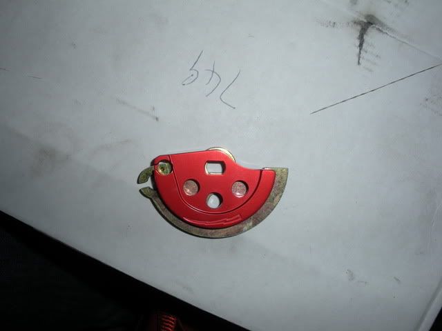

Here is the new and old throttle cam together:

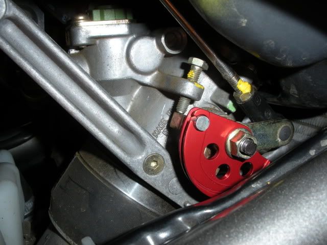

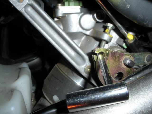

I was right about the installation, it was cake. I used a tool to lock the old throttle cam (see pic.) so it wouldn’t turn when I unscrewed the retaining nut.
I had to adjust the throttle cable free play (tighten it) as the new cam has a smaller circumference. I also had to adjust idle speed as I found out that day at the track. That’s an easy fix and can be done with the bike turned on (which helps because you can see/ hear the RPM’s change) In the picture you can see a short semi-vertical bolt with a yellow dot of paint on it(there are two yellow dotted bolts in the picture, here i'm referring to the small one on the left. This adjusts idle speed, or at least that’s what I use it for... Depending on which direction you turn it (clockwise/ counter-clockwise), it will change idle speed. Please note, i !DO NOT! mean that long bolt with a yellow dot on it, to the right, the one that disappears into the top of the picture. Don't touch this!

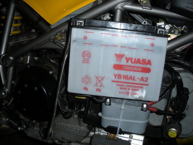

The turn-tech battery: Very cute. Cost was 157$ with shipping (very speedy). It weights 2 pounds as opposed to the Speedcell which is 1.6 lbs and cost 250$. On the down side, this battery is designed for dirtbikes while the speed cell advertises itself as a superbike battery. Here it is difficult for the layman like myself to know what is just advertising and market targeting and what is really true about performance characteristics. As per usual, I took a leap of penny pinching faith and went for the turn-tech.

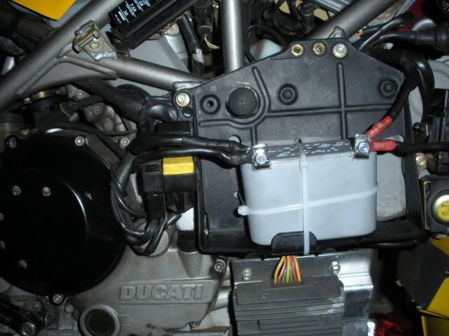

A size comparison:
Didn’t have much trouble fitting it in. The wires are a little bit tighter now but nothing is in danger of breaking and no changes needed to be made to the battery box and wires to fit it. I did drill a hole in the battery box so I could run a zip tie through to hold the turn-tech in place. I also cut four very thin rings (about 1/8 inch) from an old coolant hose that I had replaced after my last crash and used them as cushions: two under the battery and two behind it. I zip tied it in place and prayed that it would continue to start my bike all day at the track, which it did.
I must have started it about 15-20 times (7 track sessions, I think, plus a few short trips around the pit for gas, registration, suspension etc.) The engine never had trouble turning over. It started right up every time. I had brought the old yuasa, fully trickleated, just in case the little turn tech pooped out on me…
A size comparison:
