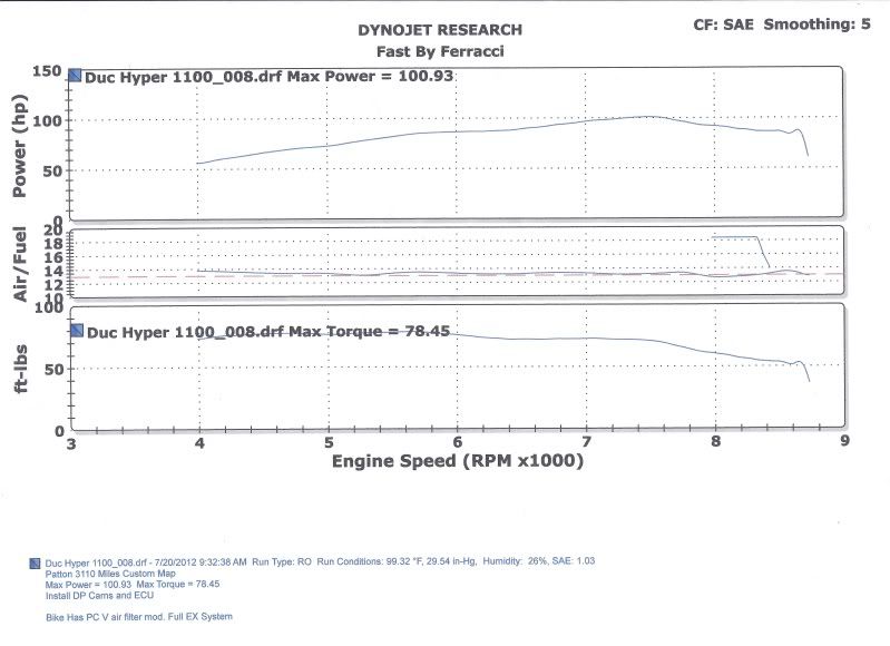

Just got my bike back from a cam kit install (advanced) and fuel map performed by Eraldo Ferracci himself ,I'm pretty happy with the results .Serious difference in power,it now has a slightly lumpy idle and sounds meaner at higher revs . Seems still to be "happy" below 3000rpm :D
Must get some monobloks,this thing is wide awake now (# would have been slightly higher with a 15t sprocket) :D

?#1 Duc Shop stacks, light flywheel, LV exhaust ,Cam's ,and a PCV.
?#2 It did em before but now 3rd is how 2nd was before the flywheel and sprocket.
