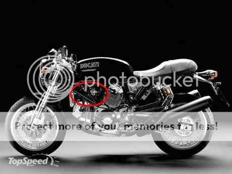

I would like to relocate the ignition on my Sport to a location on the side of the bike. Specifically, the left side. See photo below:
My main concerns are the anti-theft system, and heat issues from the engine.
Thoughts/concerns/suggestions/ideas/critisizms/blatent hate posts welcome. :D

I don't think it'd be too difficult, but you might have to fabricate a mount/enclosure for the switch gear, since the frame isn't the same diameter as the bars.
But I'm curious why you'd want to?
1,625 Posts
there is a small ring antenna inside the plastic cover for the ignition switch - you'll need to make sure that sits in the same relationship to the key or it won't work. probably the easiest way to do that is re-use the ignition switch and cover on a fabricated mount. not sure if you'll have enough length in the wire loom to reach your desired location without some surgery, but i say go for it!

I did some investigation, and I'm not sure how to get the ignition disconnected from the bike. I took the cover off, but it seems like the whole assembly is pressed down onto the frame. I saw no other screws or bolts holding it on either.

Have you considered the neck lock? You will be sacrificing that to move your ignition, plus it will be hanging out the back of the ignition cylinder.
You can kinda see here what your trying to pull out.

I have considered that. I'm still not sure I want to do this, but I'd like to maybe mock it up, and see how much of a problem it is.
I'm still not sure how to get that ignition off the bike though. I may have to buy the service manual so that I can get more info.
