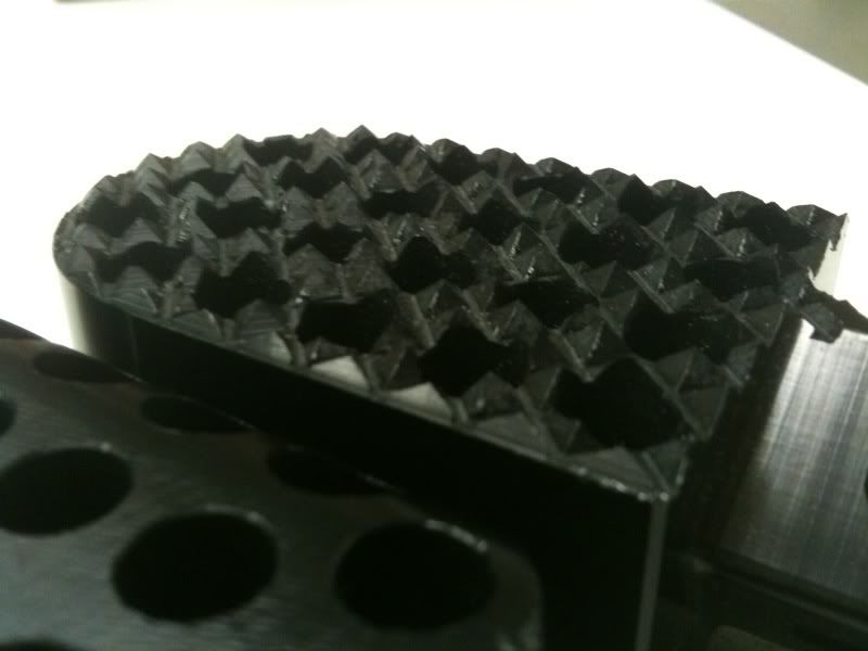

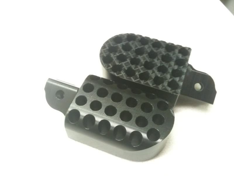

Just got my new SWAT foot pegs in. Any chance anyone could give me some help on removing the stock. It looks like just a pin with a spring??? does it need to just be knocked out??? any help would be appreciated.
Thanks much,
Jeremy

Yes its just a spring, remove the c clip on one end and push out the shaft. They go back together pretty easy.
Edit: if you are having problems, When I did my pegs I had the peg mounts off the bike possibly making it easier? I never tried doing this with parts still attached to the bike

I had to remove the clutch cover to pull the right side pin. I have a Speedymoto cover and it just wouldn't clear. Don't know if it's an issue with other covers.

Mine came out OK, without any issues or interference. A slight tap, and the pin was out.
If I recall....there was a circlip....For that....a set of circlip pliers is very handy (they work in reverse, jaws open when handles are squeezed and have two tabs for spreading the circlip open).
I mounted the shift-tech black pegs, and I now have more room for my Revit boots (extra adjustments did the trick).
