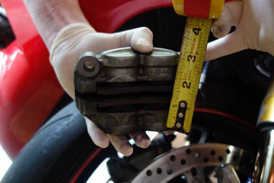

I got 9500 miles out of the stock pads. Could have squeezed another 1000 out, but I don't want to be stuck in the middle of nowhere with no garage, no tools and nothing but backing plates to slow me down. So I headed over to RSRs garage and we swapped the stock ones out with EBCs.
'Normal' calipers allow removal of the pads from the top, but the forged Brembos on the 1199 have a solid bridge running across the top of the pads, necessitating removal of the caliper.

Wiggling the caliper slightly will push the pistons back, giving you enough space to angle it off of the rotor. Once out, angle the caliper to access the pads, while being careful not to crank on the brake lines (note: this pic was taken from the ground up. Don't try flipping the entire caliper upside down or you'll crimp the brake lines, which could result in brake failure):

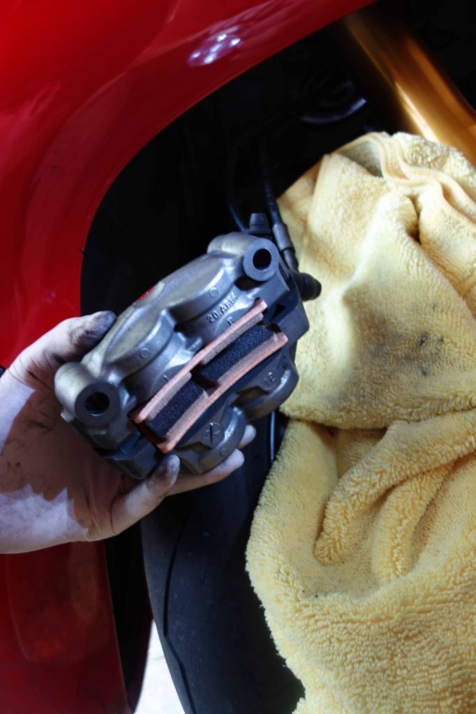

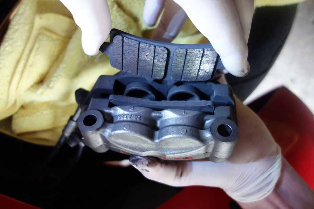

Push down on one pad (doesn't matter which) and wiggle it out. If you notice on the pic below the pads have little 'winglets' that fit into slots forged into the inside of the caliper. To get them in and out you need to apply pressure to the pad, which pushes the 'headles man" clip (that you can see in the center of the caliper in the first photo) back and allows you to angle the pad out.
Important: Don't remove both pads at this point. Keeping one pad in keeps pressure on the little clip, making installation easier.

Installl new pad by pushing into caliper (down/back) and angling it around so it slots in place. (By keeping a second pad in you also will be able to visually check that it's in the proper place by comparing it with the stock pad.)
(Notice winglets and the differences/similarities between the two pads)

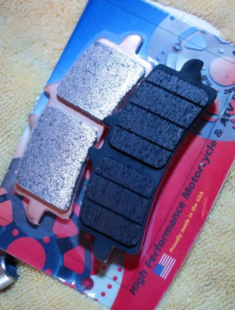

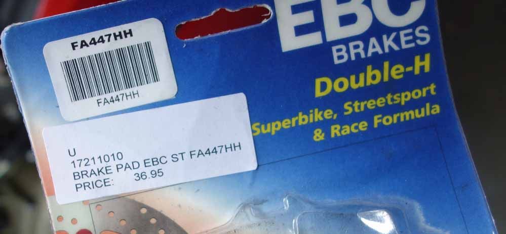

Part number for 1098S EBC pads:
Note: One 'pad' is larger than the other on each brake pad plate. The larger pad on each side should be the closest to the ground and the small pad should be at the top. The stock pads are 'staggered (you can see it in the picture of the stock pads above). No one is sure why Ducati does this, but the pairs that EBC sells are not staggered. You either install them with both large sides down or both with large sides up.
