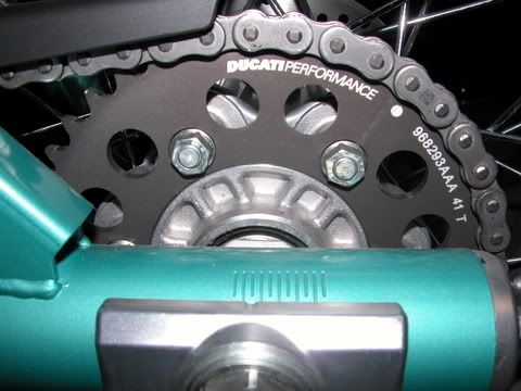

Just did the 41t Ergal rear and it makes a HUGE difference. The stock gearing is very high but now it's hard to keep the front end down in first.
I went one down in front and one up in the rear (14/39) and it still doesn't feel like enough. I've got about 800 miles on it now, but I'll wait for more break-in before I really get into it and see if need to go to 14/40. :think:

Stock chain worked fine, I was more concerned with the chain guard clearance but that was ok too. I did have 600 miles and had adjusted the chain once. Highway cruising still tolerable in 4th so a 14 tooth with the 41 on the back should be fun without sacrificing any top end.

Just took it out and it runs into the rev limiter at about 120 mph in 4th gear (22/24 ratio) and sixth gear is an overdrive (28/24 ratio). If I'm doing the math correctly that equates to a top speed of just under 153 mph if the bike had the aerodynamics and horsepower to pull that off and that is with a 15/41 combination. I think I'll go ahead and order the 14 tooth front because that gets 142 mph + top end and a whole lot more low speed entertainment. Of course my math could be wrong and that's gonna force me to take another ride :)
I've had 14/41 for a while, with a better new chain. It runs at about 4000 at 70 in 6th.
The best part of the 41 tooth is the quick run thru the gears from a light. It pulls hard thru 4 quick shifts to break out in front, couldn't do that with the 38, it wanted to stay in the 3 lowest gears to long to feel the HP.
I just took it out for a quick spin and in 6th gear it runs a tad under 3500 rpm at 60 mph. 60/3500 x 9000rpm = a theoretical top speed of 154 mph. I really don't think a bike with 83 hp at the crank and a partial fairing is going to do much over 140 let alone the 7.33% increase to 165 mph that stock gearing gives. Doesn't matter anyway, if I wanted to go 180+ I'd get a ZX-14R.
