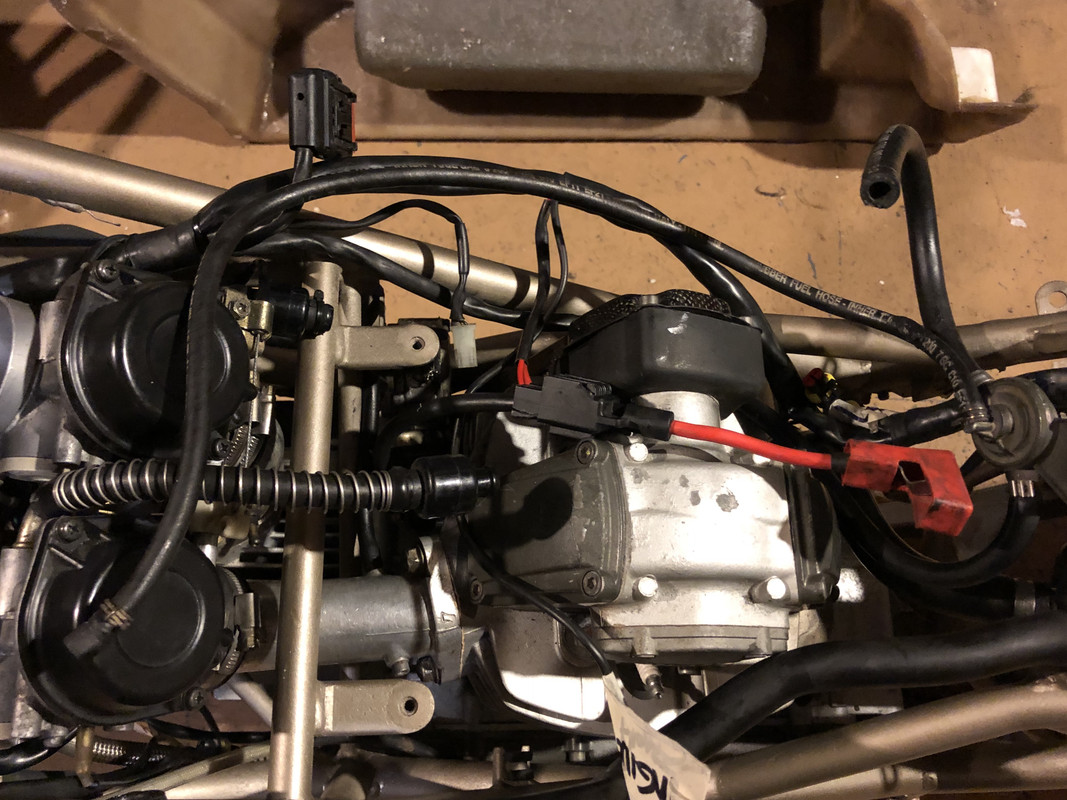

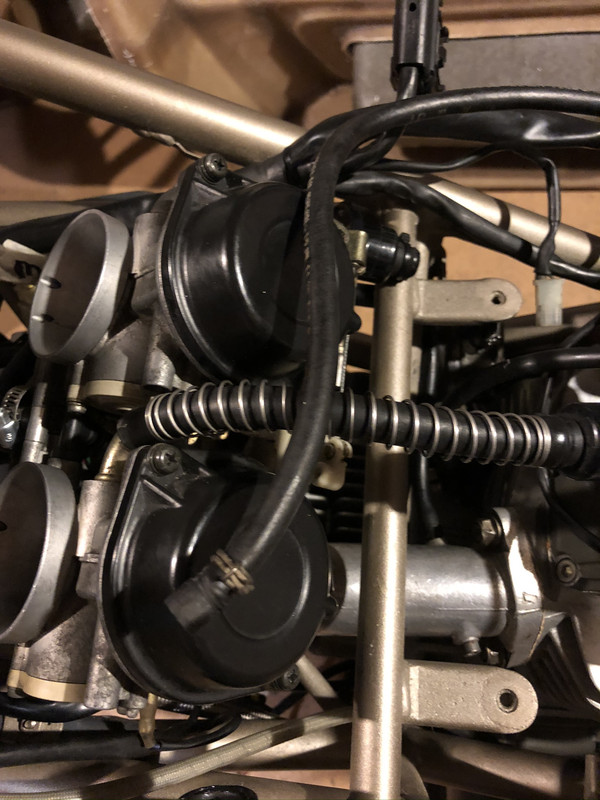

I’ve connected the main fuel line, the heat riser wires, the vent hose to the side canister and I have a hose that I don’t know where it goes.
It comes from the center of the fuel junction but I can’t find wher the other end goes to.
Anyone know?

It’s part number 7 Fuel cock/ inlet duct pipe. I just can’t see where it attaches. I have the carb off of the manifolds so I can see all around the carb. Just can’t find where it goes.

I looked under the tank. There is only one main fuel line and two vent hoses. The hose I’m looking to connect is the inlet duct pipe and is not shown in your diagrams.
The two hoses in your diagram attach to the side vent canisters shown below. I’m struggling with this one. I can’t find a diagram anywhere.
Does anyone have a Haynes manual for a 2000 750 Monster who can look this up for me?

Figured it out!
I’ve been staring at this diagram for days and it just hit me. There’s a fitting on the other side of the manifold also. It only shows one, but you have to imagine the other side.
When I checked, it was there!
Carb connected except for two of the large vent lines with the springs.
