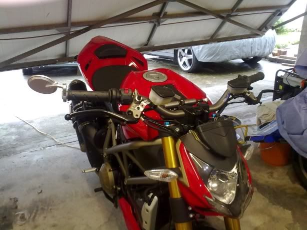

Put the Renthal Fatbars on.
http://www.bandcexpress.co.uk/cgi-bin/bc_page.pl?cat=HB-FATBAR
A relatively easy job.:rolleyes:
Titanium coloured matches well with the brake and clutch brackets.:eek:
Re-routed the cable etc outside of the headlamp housing unit.:rolleyes:which just lifts easily out of its 2 locators.
You do have to drill 3 holes in the bars at various location to accomodate
the small anti-turn lugs inside the switches and the throttle handlebar housing.:eek:
Haven't been for a spin yet,raining again,but they feel much more user friendly now,so shall report back later.:abduct:
Oh Yea,I binned the pillion footrest hanger as well.

Hi Chris,
Reason for changing was, I have a bad neck and spine from too many miles on an SRAD,18,000 in the 1st year, oh yes and 25 years of building work.:eek:and I found the stock bars on the SF too far forward.:mad:
I also prefer to ride motocross style which,with wider bars gives me more confidence,I tend to lean the bike over rather than hanging off it.
Fat Bars are 28.6mm (1 1/8” )n the middle which fits the SF Top Yoke clamps and then they taper down to 22,2mm.(7/8”)
This allows you to fit the standard controls on the bike
The Bars also flex very slightly which reduces fatigue on the rider.
They are normally used on dirt bikes.
I also noticed whilst doing this that the handlebar clamps are rubber mounted which would reduce vibration ,jolly thoughtfull of the Boffins at Ducati....
The colour is Titanium which is slightly darker than the frame.
Go here for a look.:alien:

hedetrimmer, would you by any chance know the inside diameter at the ends? I ordered a set of Oberon mirrors based on someone saying they're 14mm id tube (stock bars) but I'd like to do the mod you just did without having to buy another set of mirrors. (I don't have the bike yet)
Thanks a ton!
Thanks a ton!
The bars were 22.2mm minus 5mm thick =17.2 but you can get bits to widen the internal expandy gadgets that hold the bar end mirrors in position or just cut some inner tube around to fill the gap or even silcon them in:sleep:
Here's the ones I got and they fitted straight on.:eek:
These ones give a very good idea of who's behind you ,oink,oink.:eek:
http://www.busters-accessories.co.uk/productInfo.aspx?catRef=MIB1&kw=bar+end+mirrors
These are the ones I've ordered
http://www.oberon-performance.co.uk/acatalog/Bar_End_Mirrors.html
As you said, anything can be made to fit. Thanks again!

Hedetrimmer , any chance of measuring the width of the Renthal bars? (end of grip to the other end). I have no complaint for the stock bars being low but they seem a bit narrow for me.
Fatty Bars.
Yeh,they're 780mm wide:eek:
