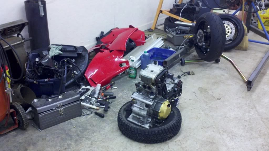

No posts of the stripping all of it down as i just hammered out as much i could today...
Stripped out all of the front and back looms, radiator,chain,subframe,front end etc...
Drained the oil and water....
Noticed a few bits of metal shavings on the sump plug, so thats another thing to have a look at....
Most of the wiring has rubbed like fuck on the frame causing a bit of rusting :(
Heres a pic of todays efforts... (i will be taking a lot more pictures now, esp of the rebuild and engine out.... and belt changes)

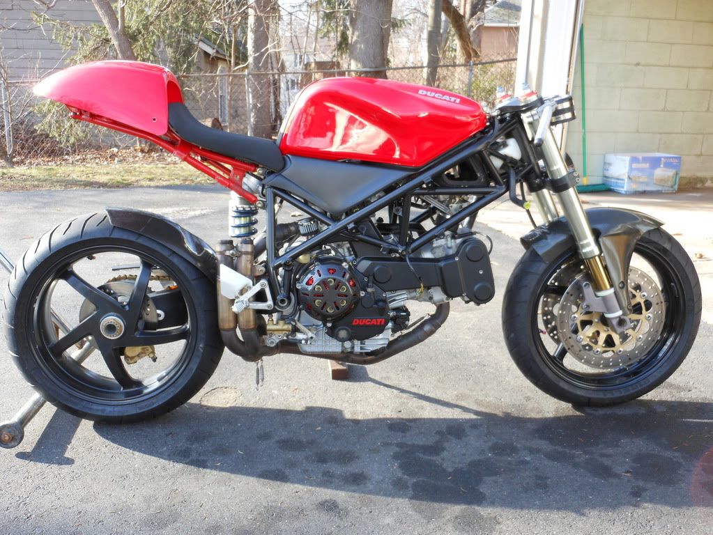

Looking good there...well relatively speaking lol. Getting it torn down is the easy bit. I did this to my 748 the day I picked it up (1500k but ridden hard and put away wet at the track). Just be patience and take you're time. I would suggest powder coating the frame, much more durable than paint and won't rub through.
Just as an example, here's mine thus far after about 6 months of work (and too much money lol). I had my frame powder coated as well as the triples.
Make sure you label EVERYTHING! Especially all the electrical connectors. I'm not running into some trouble remembering what goes where as there are several item that use the same style connector on the bike. I'll prob have to steal my buddies 748 for reference lol. Good luck with the project!
