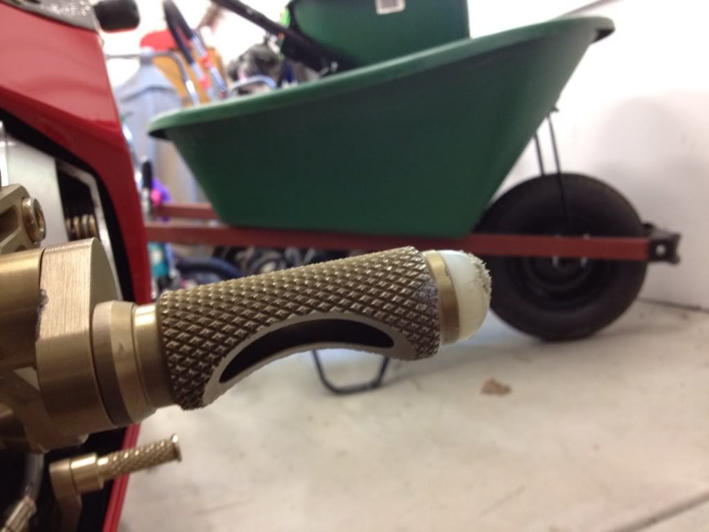

I was told they are Sato but they're not. I'm wanting to get a new puck for them. I'm also wondering if (like the Sato's) I can change the link around and go back to normal shift pattern (1down 5up) vs. the current GP shift pattern.
Any help appreciated...
Thanks,
Toran

Thanks nfwb11, I checked all of those but still couldn't find a match. Looked all over bing images and again couldn't find a match... I'm hoping someone might be able to offer some help. I'm guessing maybe a small company or more likely a knock off of something... Any ideas or help appreciated.
Thanks,
Toran

The rearsets themselves do look a lot like either Sato or Woodcraft, however I have never seen heel protectors that look like those anywhere. I would remove the rearsets and see if there are any part or identification numbers etched somewhere.

Thanks Proph... that was the next order of business, gonna rotate the footpegs forward anyway... I'm doubting that they are in fact Ti as they were described as I am assuming they must be knock-off's, I'm guessing Woodcraft knockoff's. They work well and look nice so I'm not too disapointed I was just hoping for a manual to see if I could change the shift link and make it the normal shift pattern rather than the GP shift pattern. I'm getting used to the 1up 5down pattern but going back and forth between the Tuono and the 998 I'd rather have the same muscle memory in a pucker moment...
I know the Sato shifter link can be changed to switch between the normal shift pattern and GP pattern, does anyone know if they all can be? I assumed that it was the actual clutch itself that would have been changed not simply a link arm but Sato says theirs can be changed so I'm wondering if all of them can...
Toran

You can measure the puck size and see if Motowheels , Sato or other rearsets manufacturers offer the same size as a replacement..otherwise you could always just remove them.

GP shift has nothing to do with the clutch. it's all in the way the shift arm pivots. you can always just get a new shifter arm (stock one even) that should still work fine with the rearsets you have. after all the shift arm is not attached to the rear-set in any way.
otherwise they are nice looking rearsets. :) just measure up the ID of the end of the footpeg you may find it's the same as other brands and a end cap from somewhere else should fit it fine.

BB you rock, thank you, that's some helpful info to a Ducatisti newbie... I'll be looking for a new shifter arm... do you kow if there is a tutorial online for changing it out? I'm sure it's gotta be quite easy but I'd also rather not knacker up the bike out of ignorance...

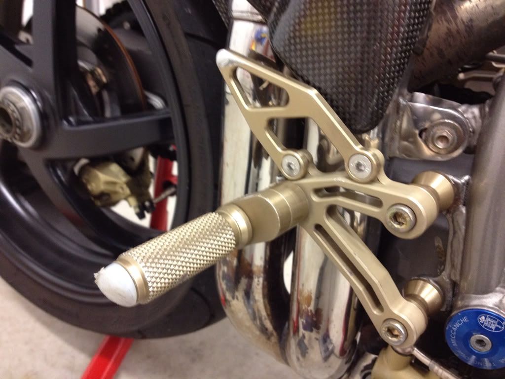

They are definitely not Woodcraft, Sato or Acculign. I've never seen these before so they aren't from any of the "standard" suppliers in the US. They must be from a more obscure manufacturer, but who knows how to track them down.

still think they are good looking rear-sets. regardless of if they are copies or ebay specials or whatever. they look fine to me. the eccentric peg mounts are always a good idea as it makes it easy to adjust peg position and the pegs themselves look to be a nice size and have the good/grippy type of knurling on them, and the heel guards look cool too. i say keep them or give them to me!! :)

They are actually pretty well made and they could be Ti but I'm assuming alluminum. Very light weight. I took them off to make some adjustments and they seem pretty well made. No manufacture markings anywhere though... I'm sure someone will offer a replacement puck for them. I've got a few pics to see if there is anyway to change back to normal shift pattern. Let me know if there is an easy fix for this... (I'm not sure there is though without a new shifter...)
Here are the pics:
It looks like it was installed upside down as it is impossible to back the locking screw out (can't get a head between the case and the screw head). I'm gonna have to remove it with plyers and chew up the screw a bit (I'll get a replacement from hardware store). I don't even know how they would have gotten the screw tightened down to be honest...
So, is there any way to change this back to regular shift?

To switch to standard shift you need a linkage and the lever to mount to the rearset itself. I don't see a mounting point on the rearset at all so I think you've got a pair of GP shift only rearsets.

Plus 1... totally agree with Anthony. These "could" be modified with the addition of some of the stock linkage assembly and then attempt to mount the shift lever concentrically with the lower rearset mount point using a longer shoulder bolt, retaining nuts, delrin washers, etc. etc. but it would be MUCH easier to just purchase a replacement pair of rearsets. If you are not into dropping much $$ on something like this right now you could check the classifieds here or eBay for a good used pair.
