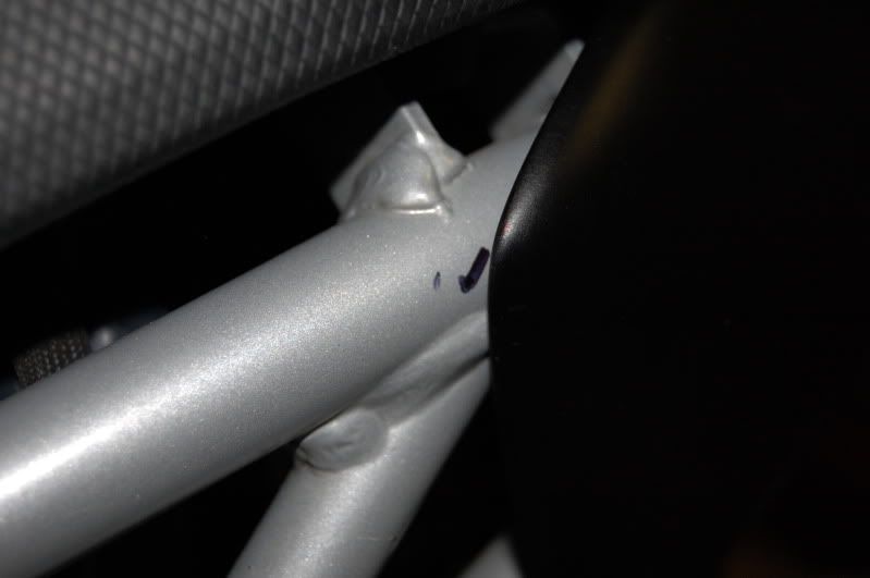

I had bought the termi 2 into 1 race kit quite some time ago so I didn't have completely stock rear. So I'll start with just a bare subframe and the install of the seat bracket.
after I had this installed I lined up the tail section and marked my rear subframe so I would have a reference of where to drill
I did this with the seat on and then took that off and got to drilling.
one side drilled sigh of relief - really wasn't difficult
on to the next
before I wired everything up I made sure I had a good fit and it was like a glove
