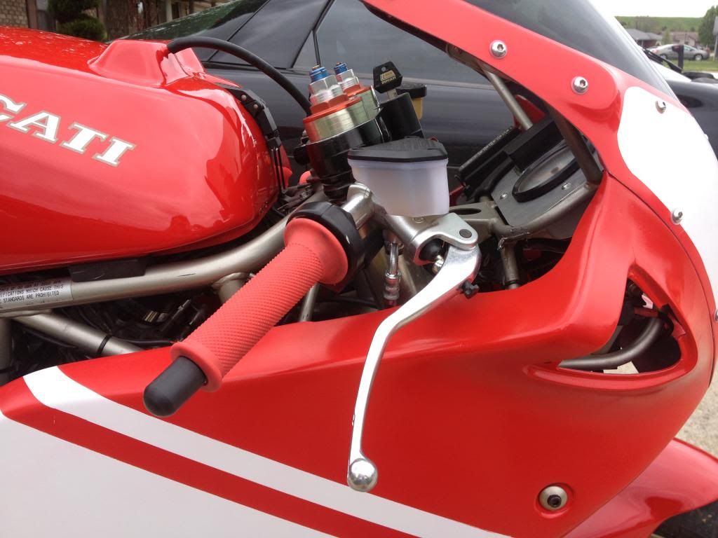

Its been a couple weeks since I posted any progress, because progress has been slow :( I got the brake line on and bleed, had the suspension set up by a local suspension genie and finished up the dash. Got my race front fairing in last week and fitted the bodywork. Decided on a paint scheme last night and laid the paint down on the side fairings, will do the nose and tail tomorrow!
Now for some pics...
The dash is done, aside from a ducati decal or two:
The body work mounted:
The layout of the front number plate, I have a similar one on my 916, I dig the one sided look:
Finally the paint on one of the side fairings, design stolen from the D16rr:

She is now TRACK READY!!!
The paint went on well, although not without complications... Apparently Rustolium professional paint isn't compatible with Rustolium Gloss Enamel, had to repaint all of it after the paint developed a wrinkle finish 5 minutes after spraying all the pieces... Left the clear coat off this time, went with a good medium cutting compound from Mcguires that works well enough.
So here is the rundown:
Rebuilt valved and sprung 916 front end
999 Radial front brake master
998 clutch master
XRAC sintered front brake pads
Michelin power one competition compound tires
99+ rear shock (raised the ride height about an inch, suspension guy said its perfect)
Sharkskins front fairing without headlight cutout
Ca-cycleworks coils (yet to be installed)
39mm FCR's
5.5" rear wheel
underslung rear brake
New front and rear brake and clutch lines in blue
Woodcraft rear sets
Full Ohlins and possibly a 1000DS engine are in the works for next year :)
When I bought it 7 years ago:
After years of neglect and an inspiration to have a dedicated track bike:

A few more:
I welcome any critiques, suggestions or maybe some good deals on extra parts you guys have laying around!
