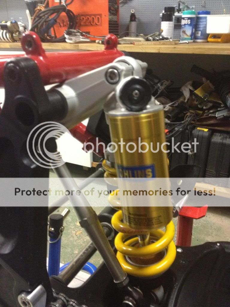

Does anyone here have any experience with the Bursi frame? I'm putting together a trackbike based on the Bursi frame and my intention was to use a 749R rear shock w/ linear linkage. However, when I tried to mount the shock and linkage I ran into some problems.
The linkage pinches the top bar of the frame and can't pivot any further.
Is there a different geometry of the Bursi frame compared to the regular frames?
I have had a regular linkage w/ a MUPO shock mounted before and this was no problem.
Any ideas?

That looks strange. Something must be wrong as Bursi would not produce a frame that will not work with OEM Ducati parts I think. I checked the 749R rocker on my bike and yours is mounted the same.

Did you get the 749R ride height rod as well? It's shorter than the non 749R one.

dont worry ,once the wheel is on and the bike is down you wil have all the Clarence you will need. I also have a 749R rear set up and thought I had the same Clarence issue.

that tie rod is too long to be the genuine 749r one and the rocker is wrong too that looks like the std one. The genuine 749r rocker has a much more acute angle and shorter front section.........

when the 749r one is fitted on the bike and you look from the gear lever side, the shock eye hole is at say 0100 and the tie rod top hole is at around 0700 and looks at a steep angle
to the OP you need to see where its at with the swing arm angle sitting at say 240mm as measured on the ducati swing arm datum tool .

This is the suspension w/ linkage and adjuster rod. Seems odd that it would be the wrong parts since they come straight from a 749R ridden by a fellow Ducatisti here in Sweden.

Hmmmm that does look correct from there.........have you set it up with the swing arm at the correct ride height

I think it is just that you have no weight on it . The shock is fully extended. With a little weight the tie rod will push it away from the frame .

+1 on the weight. I swear that FBF had a 999 with that type of frame addition on it, I'll check when I see them later in the week. I recall seeing one as I thought it mimic'd Terblanche's original CNC'd part that was to replace the frame in that area so it would not look like a plumbers pipe/tube. It wasn't as bulky, Terblanche also built a better looking sub frame, however both were dumped due to costs.
