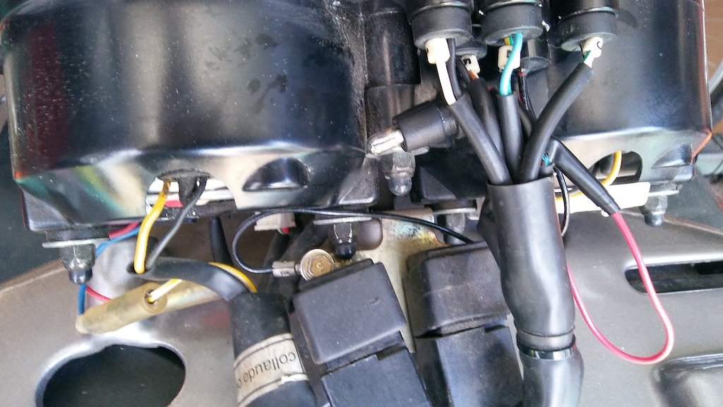

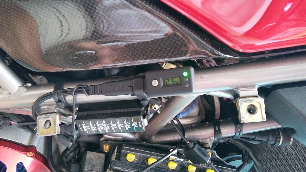

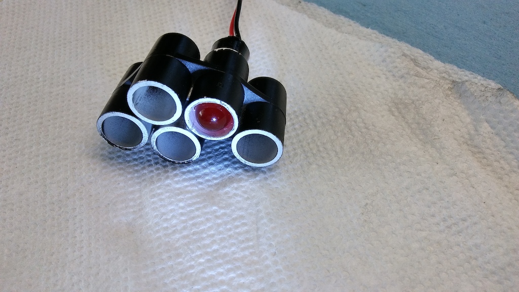

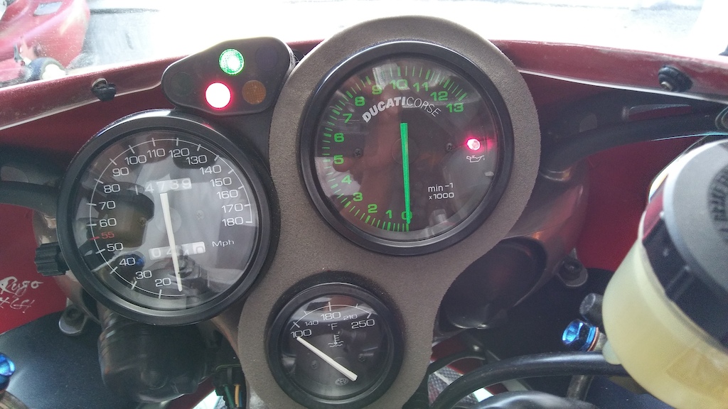

this is the new led bulb unit-12V Universal fit RED LED Alternator Battery Warning Light Charge status monitor | eBay just need to enlarge the oem socket & order without the outer flange attached.I used a drill bit by hand after removing the bulb pod.my 2000 996S has a live blue wire at the correct pod so I spliced-soldered onto it.for the ground I attached a small screw to the nearby relay mount plate.works well.the red/white second wire lead in the org.socket isn't to any circuit so tucked it out the way & left org. bulb intact for a spare.Bat. Tender gizmo is added security.
