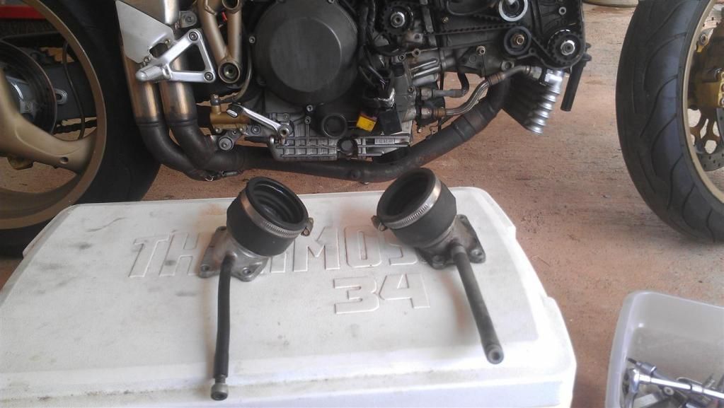

I just got this 99 996 last week and I am curious about the 2 hoses attached to the manifolds that are capped off and also the hose was not connected to the fuel pressure regulator under the tank and the other end of the FPR hose just hangs down. Shouldn't the other end of the FPR hose connect to the manifold for a vacuum signal?

FPR is open. Do a search, it's been covered, including with photos.

Remove the hoses, cap the holes (or get small bolts with copper washers to seal them) and forget about it.

i'm betting someone left the hoses on to make it quicker and easier to sync the throttle bodies.
5,164 Posts
Indeed, on my 916 it's almost impossible to screw an adapter into the rear intake whilst the airbox is fitted without cross-threading it and as I have the TB's in the airbox it's a long job to remove the box so I leave hoses on my 916 TB's for this purpose - just make sure they're plugged.
And the FPR should be left open.
