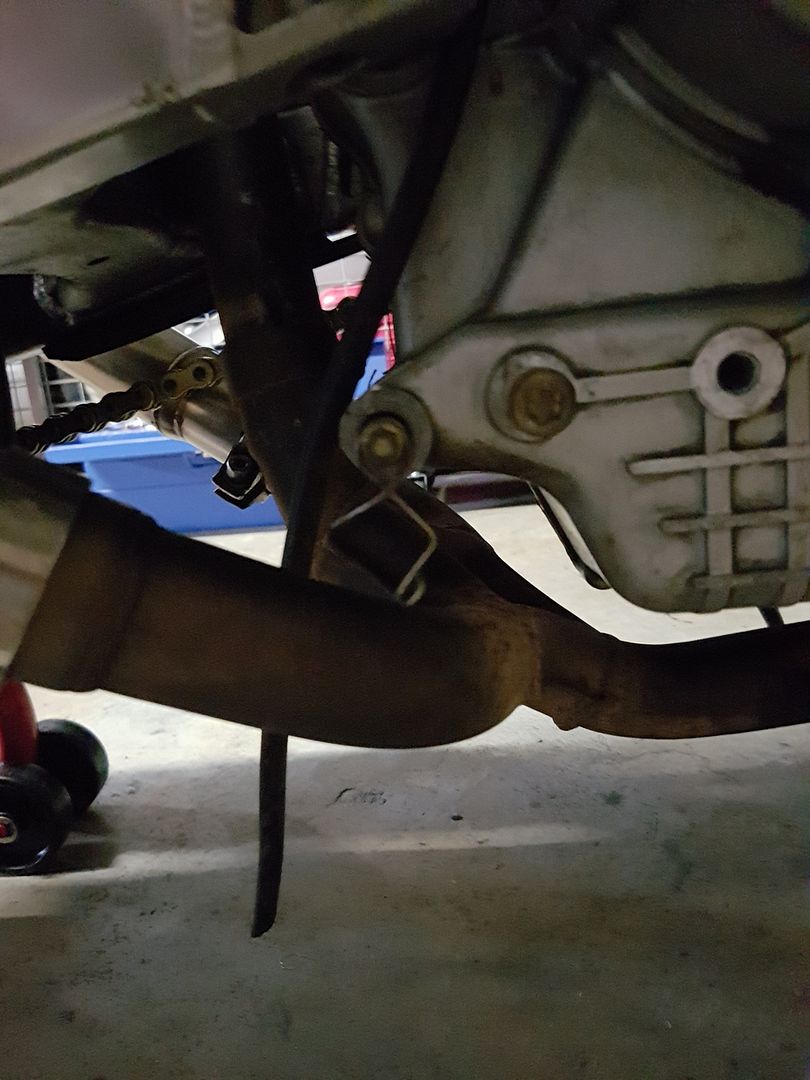

My Anderson stand rocked up, looks nice and sturdy.
I loosened the rear master to get access to the "unused" engine mount, but looks like there is a threaded bush mounting a hose guide for the fuel tank overflow/vent. Is it just a case of knocking this out with a drift from the other end? Don't want to damage anything if I don't have to, just looking for advice from someone who's done it before. Cheers
3,977 Posts
usually the rear brake master sort of covers that hole.
but yes, remove the screw and tap out the bit inside there. spray some wd40 or something like that down there to make it easier.
