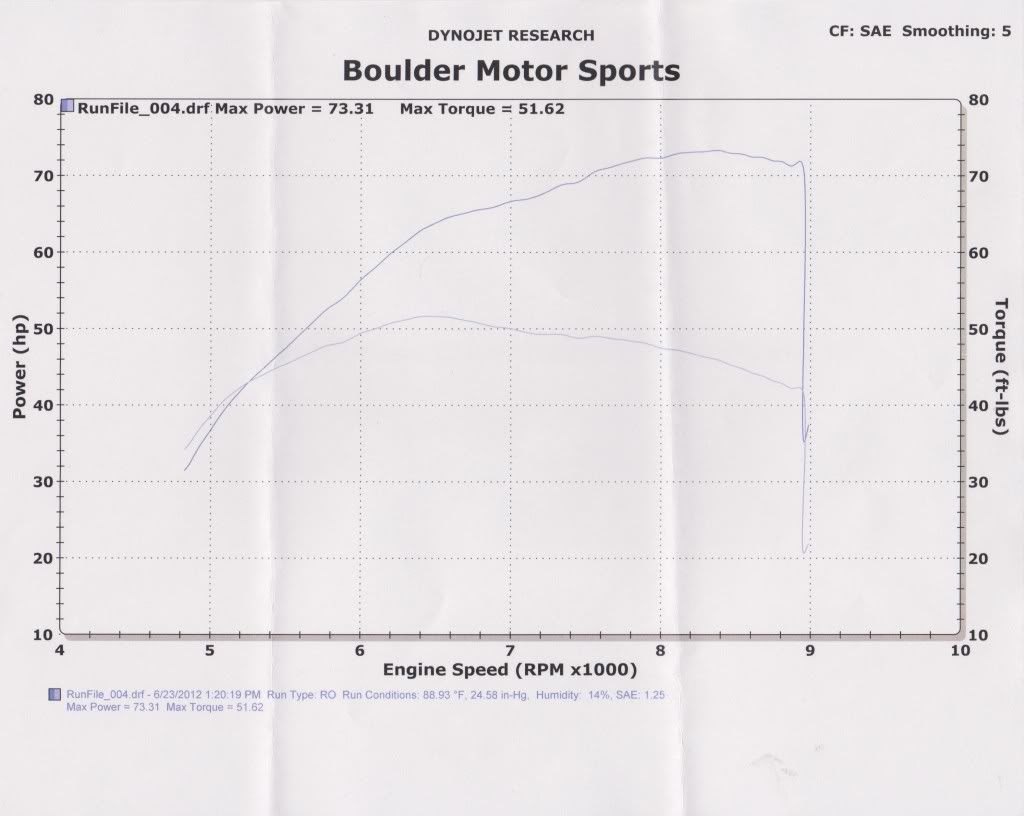

I just got my bike back from the 7500 mile service. I have a Leo Vince cat delete with stock cans, Rexxer reflash with O2 sensors removed and a 14 tooth sprocket. I'm pretty happy with the results considering the dyno was performed at a mile above sea level.

I guess the LV decat and KN filter doesn't really add that much.
where would you say should one be for maximum power—6500 where the max torque is or higher where it's closer to max HP? Seat-of-the-pants says 6500.

Nice job on all the mods !!! Good numbers on the dyno !!

how come it only starts at 3000rpm? i guess we can only squeeze so much out of that engine.
