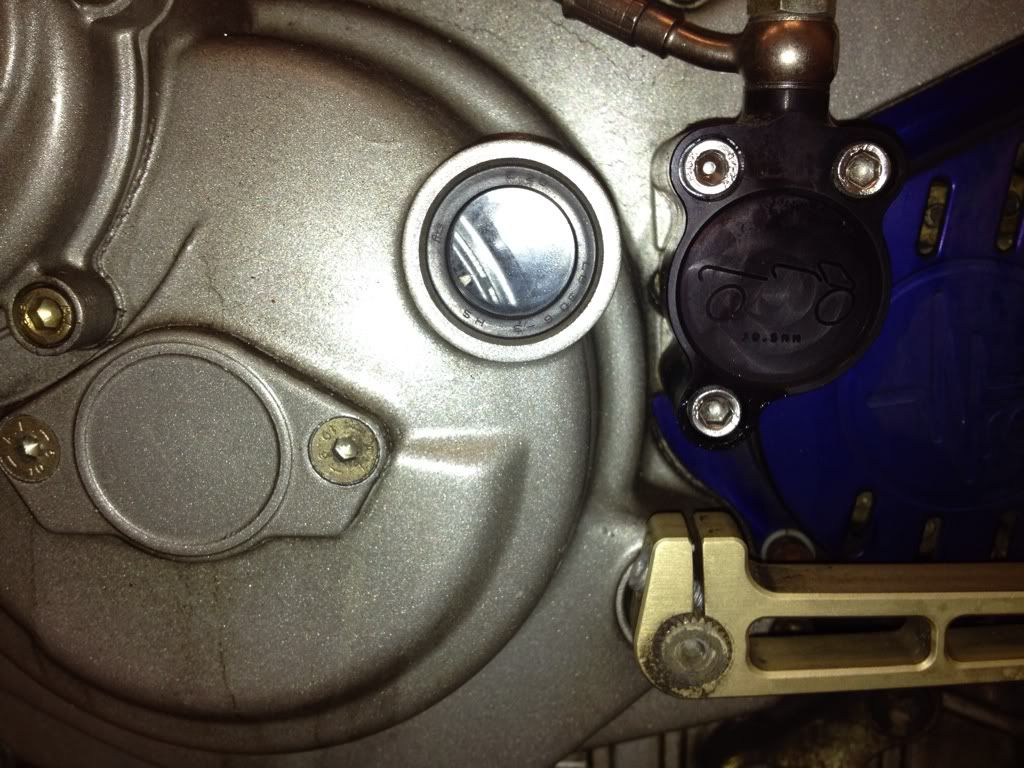

Questions #2 Should I see any fluid in this site glass. Oil level looks fine on the other side but it's weird to see a sightglass with nothing in it. New to Duc's so I'm curious. (Will be downloading manual in a moment to see if it says anything).
Same pic Question #3 So I am pretty sure this is an aftermarket clutch "something" (Black covered round piece clutch line goes into) and was told that it helps ease the clutch pull (which the clutch is quite easy to pull, much easier than I expected on a dry clutch anyway). Any info on what this is and what it does? The clutch does rattle and ting when the clutch is engaged (which I assume is normal on these dry clutches yes??).

You only see oil splashing around in that sight glass when the engine is running; it is routinely used to view timing marks on the flywheel.
The black device you are looking at is an aftermarket clutch slave...it has a hydraulic piston in it that pushes on the clutch pushrod when you pull the clutch lever. It is from Evoluzione cyclesports I believe.

2. no. that site glass if used to find Top Dead Centre (TDC) when rotating the engine by hand. it has the various timing/firing marks in there and you should line them up with the little arrow at the bottom.
3. it's the clutch slave cylinder. when you squeeze the clutch lever it pushes the piston in the master cylinder (on the bars), that compresses fluid in the brake lines and that fluid then pushes on the clutch slave cylinders piston which then actuates the clutch (releasing the clutch so you can shift gears)
