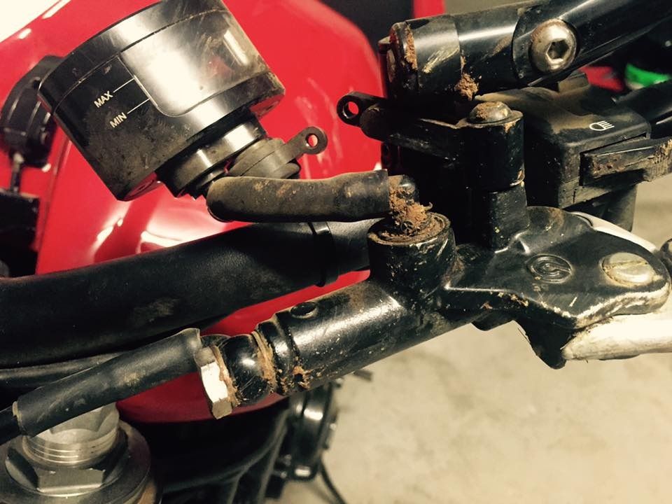

After the crash, have more basically alot of rash on lhs of bike

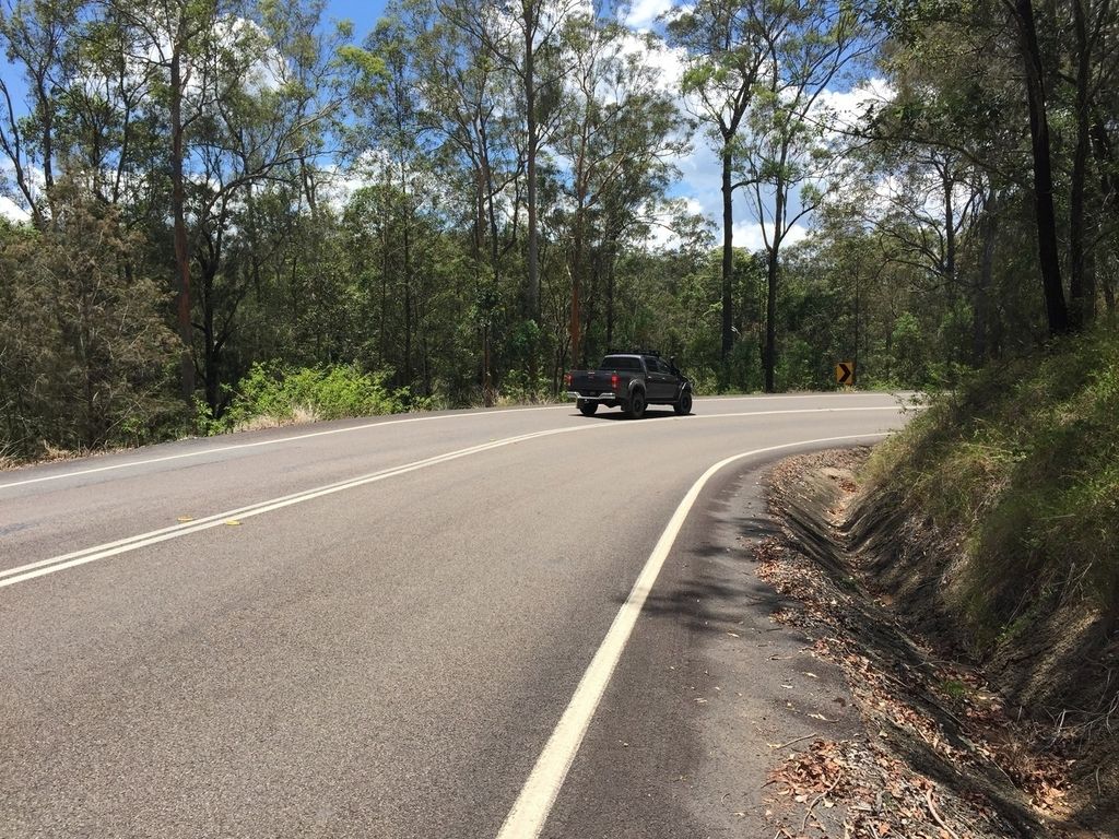

Photo of road where it all went down, roughly where car is in pic I went straight
