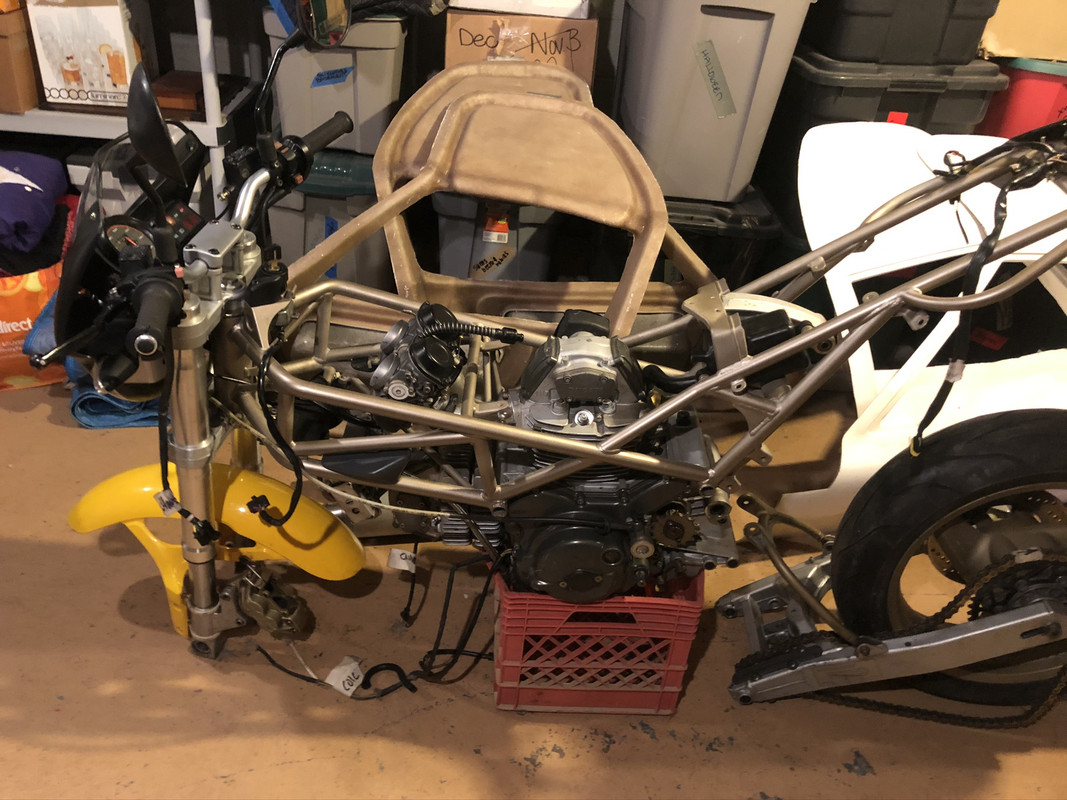

A lot of work today. Installed the new timing belts, attached the engine onto the frame and began installing the swing arm. Having a little trouble getting the swing arm shaft all the way through. It’s hanging up on something at the end of the far side. I didn’t want tomwhacj it too hard with the sledge so I decided to take a break and try again tomorrow night.
I feel good that it’s going back together!

Didn’t get a lot of work done today, the job got in the way.
I’m missing the swing arm shims so I ordered some and they should be here soon. In the meantime I did some little things that aren’t hard but have to get done. While I’m waiting for the shims, I’m going to try and do as much as I can.
So I put on the carbs and mounted all the little air and vapor canisters as well as the horn and the rectifier.
I also have the fork nice and tight and I’ll be ready for the front wheel soon.
This is the fun part. Tearing it down you learn so much, but by the time you’ve gathered all the parts and cleaned and restored everything, going back together even a little bit at a time, is a blast,

I’m learning so I’ll tell you my mistakes as I go.
Put a lot of parts on the frame today. Still waiting on my swing arm shims so I can’t do anything with the rear wheel. I think I need to replace the valve stem in the front wheel so I can’t put that on either. I’m going to try to remove the little valve in the stem this weekend and replace it. If I can’t, I’ll need to replace the entire stem. Chances are I’ll buy new tires anyway so when I get them mounted I’ll have them put a stem in, or I may mount them myself. I’ve mounted motorcycle tires by hand before, It’s no fun, but it can be done.
I installed all of the front end controls and the carbs. What a pain in the ass it is trying to figure out the carb cables and get them connected. I hope I don’t do that again anytime soon. The choke cable was easy.
I have a feeling I’ll be taking things off again. Putting this back together in the right order is hit or miss. I already figured out that I have to take the ignition off to put the air box on. I knew that but I put the ignition on anyway. I wish I remembered.
Oh well. Here’s today’s update.

It looks a little silly with the front fender on and no tire, but I really like putting this back together. It’s a blast.
I’m going to wait on the air box for now. I may have to take the carbs off again to add fuel and vent hoses; so after all the fuel system is complete, I’ll add the air box. I’m thinking that I may add the wire harness this weekend.
I’m getting there.

I also learned that I bought the wrong gauge bolts. I needed to figure out some spacers so the bolts would work. It raised the gauges up a little which I actually like better anyway.

Put on the front wheel and began running hydraulic lines and main harness. I cleaned up the valve stem and it took air.
Its beginning to look like a motorcycle.

Got a lot done this morning. Added the fuel system and the wiring harness. Everything is connected just waiting to add the air box for the coils.
Today my swing arm shims came so I’ll try to mount the rear wheel tomorrow.
I’m getting there.

The shims that came today are the wrong ones. Damn...now I have to find new ones and wait for them to arrive.
Oh well, live and learn.
