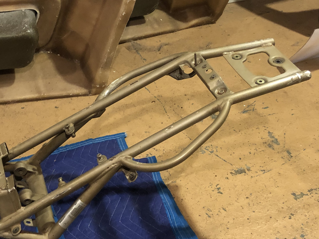

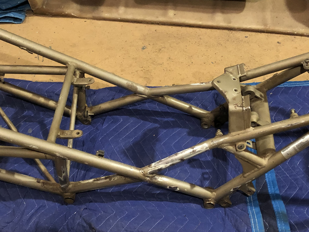

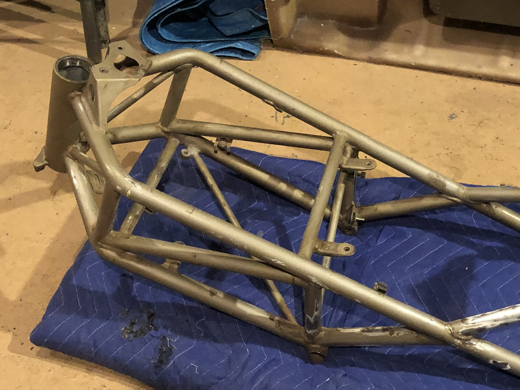

The media blast didn’t cut through the rust as I hoped it would.
On the underside there was considerable rot from what I assume was battery acid. It looks like it could have been eating away at the steel for years.
I filed and sanded for maybe 4 hours until my 61 year old body begged me to stop. I did manage to take out all the high spots from the rust and I sanded pretty well.
The frame is ALMOST ready for a primer. Still has some sanding to go. I just didn’t have any umph left.
