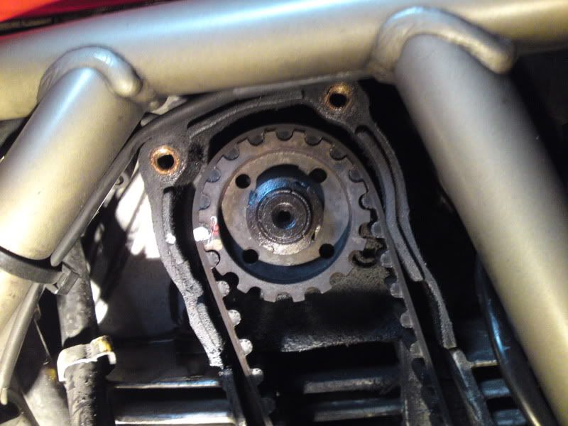

This is a new-to-me bike and sorry if I ask the obvious. I'm in the process of replacing the cam belts since they were 3 yrs old and I wasn't sure how many miles were on them. I've done several searches here and read a lot of good info and watched some tutorials on youtube. Thought I was ready for what looked like a very simple job.
However, none of the posts or tutorials mentioned that it may be difficult to get the belts on and off. The cam belt pulleys on mine have 'rims' that would prevent the belt from coming off during operation (I suppose) but also make it hard to get them off. I'm hugely struggling with the vertical one (the horizontal came off with some force), and worried that it will be pretty much impossible to get the new one on (which will be tighter).
Also, I had to remove the tensioners completely (just loosening was not enough), and thinking that I should probably remove the fixed/idler pulley also to get this done. Am I missing something?
Thanks for feedback!

Ok, done some more reading. I guess my pulley 'rims' are usually referred to as flanges and I am apparently not the only one experiencing this issue:). Sorry for not searching better the first time around. I guess I'll either have to wrestle the belts on or remove the flanges.
Still one question. If the newer ones don't have the flanges, can I just remove them and leave them off? Or is the pulley design different?

Hey guys, from what I read (after posting my first post in this thread:) ) the pre-96 have flanges on the pulleys that are not present on the later models. In all the tutorials I've seen they apparently use newer (post 95) models to show the trick since it is so much easier without the &^%$ flanges:).
Anyway, in my case it was real easy after I pulled of the flanges. With the flanges on it would probably have been just possible but I'm pretty sure I would have spent several hours and used lots of profanity in the process.

The flanges are removable (although not sure if they were specifically designed that way) and are easy to pull off with needle nose pliers. They do deform a bit in the process but are easy to re-shape and put back on. I guess I should have made pictures but I didn't think of that.
I am still curious whether the flangless pulleys are the same as the flanged ones (but without the flanges). In other words, whether it would be OK to just leave the flanges off and not reinstall them.

i pull the flanges off with side cutters and bin them. the non flanged pullies are toothed all the way to the end, but i've never seen any belt damage from de-flanged pullies.
Thank God for this forum! I had the same problem installing new belts last night. I knew reinstallation was going to be a bugger when I took the old ones off. Spent about half an hour trying to get the new ones on over the flange with no luck so I did a search and found this thread. I popped the flanges off and in two minutes my new belts were on :D My bike only has 6600 miles on it so I'm pretty certain these were the original belts. The flanges probably would have been gone if they had been replaced in the past.
If you don't want to take the flanges off, or remove the pulleys (special tool needed), you can just temporarily remove the idler and adjustable rollers (no special tools needed). With those out of the way, the belt isn't deflected on the run between the bottom end pulley and the head pulley, and you have enough slack to get the belts mounted without superhuman effort. Seat the belt fully on the bottom end pulley--make sure it's fully seated! Then slide the belt on one side of the head pulley--again, fully seat it on that side. Then you can gently guide the other side of the belt onto the head pulley. Hand force alone will do it--don't use a screwdriver or anything else as a pry bar. It's really about finesse, not force, once you've got the rollers out of the way :).
The vertical belt is hardest because the pulley wants to spin when the dots are lined up. I put the vertical belt on the bottom end pulley, then completely do the horizontal belt (bottom end first, then head end), then finally do the head end of the vertical belt--easiest if you fully seat on the rear-of-bike side of the head end, then slide around the front-of-bike side--if you do it the other way you're going the same direction as the spring wants to turn the pulley, and it's harder to keep the pulley from turning! This way, the horizontal belt holds the vertical belt in place on the bottom end pulley--otherwise it wants to slide over to the other half of the pulley while you're futzing with the head end.
