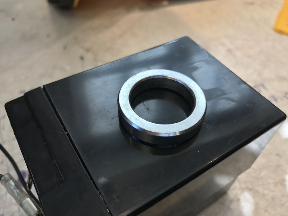

anyone have a rh front axle spacer / seal runner handy they can measure the width of? i have a wheel that moves quite alarmingly from side to side now the front calipers are off. i'll pull it out tomorrow, but it strikes me that the rh spacer is missing. i'll have to machine one up i think.
1 - 4 of 4 Posts
Do you mean the steel spacer on the spindle, like this?
If so it's 7.5mm thick, id 25mm, od 35mm.
many thanks. this one doesn't have one.
Make them captive then, if you have to manufacture some? Makes it easier to change wheels next time.
