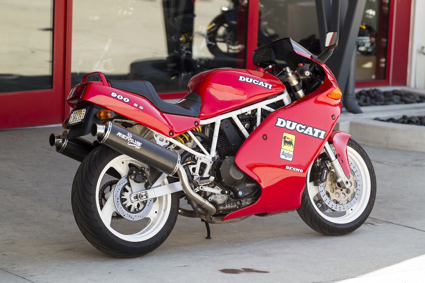

Nice job on a period correct early 900 carby.
Keep in mind those are fuel screws not air screws so the further in you put them you are leaning it out. Early 900's used 40 pilots but the carbs may not be original but later similar looking carbs that did come with 37.5's. Bottom line it will tell you which it prefers and if the heads were ported then it will want less fuel so if the carbs are right but has ported heads that might account for the smaller pilots working better.
Odd looking reaction rod on the rear brake I do not remember seeing that design before. back in the day they were mostly stock or carbon fiber tubing.

My bike had only a few upgrades on it when I bought it - carbon fiber rear hugger, clutch cover and Remus pipes, rear view mirrors all from the Corse catalog, Goodrich brake lines on the front brakes and oil lines. The original seat was included but that is a Corbin. This has the original early model black brake and mounting position on the rear, original stickers. NOS body panels with a darker windscreen added. I'm the first owner, those are manufacturers plates.
