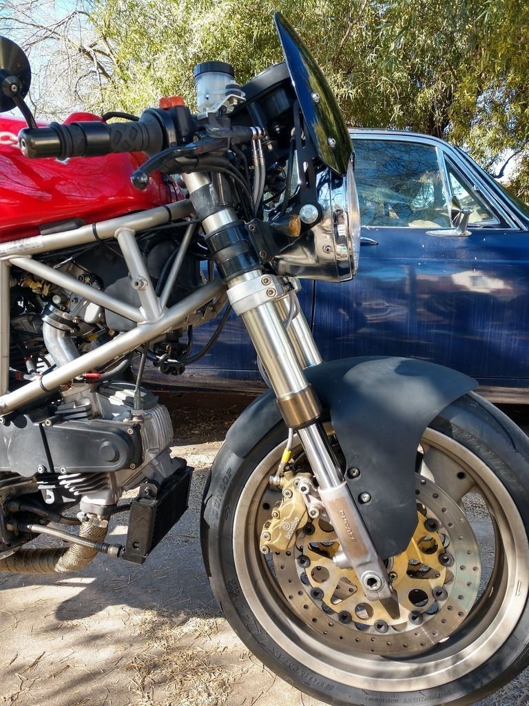

Pic goes sideways, wcyd?

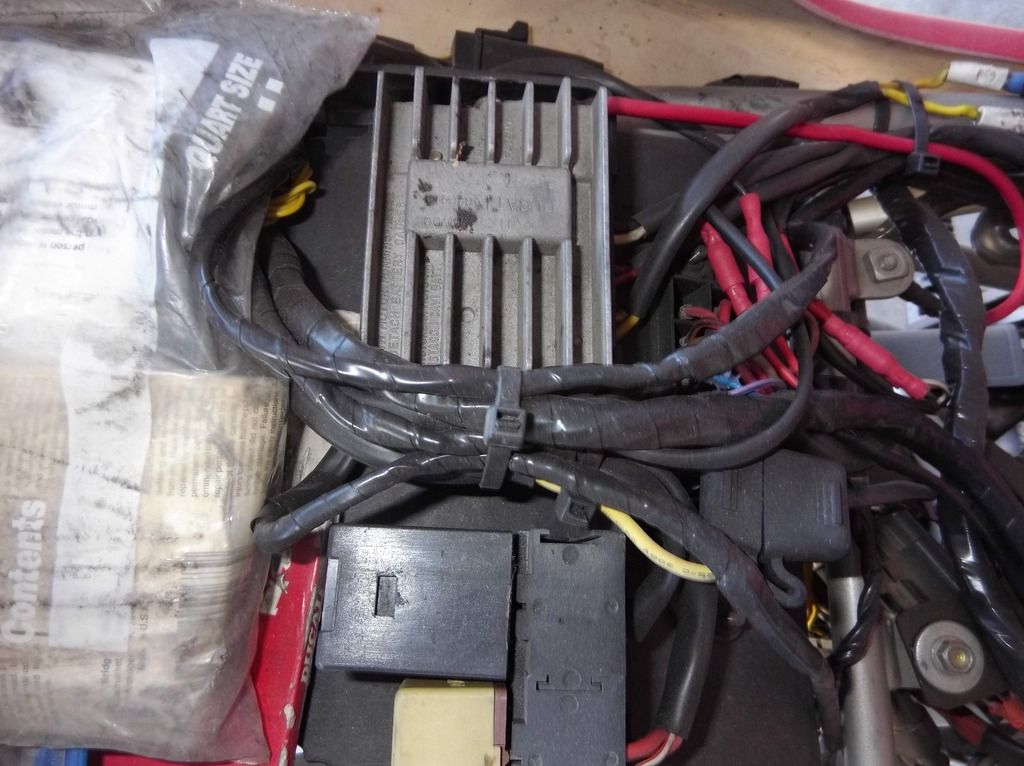

Just curious where they hid the rectifier?

My first question too after seeing it for the first time in the PO's garage - where is the ignition key, regulator,fuse box and relays? Well - all moved to the back except for the key which is on a neat mount on the lower frame like an ineffective slider. The whole thing, heavy steering lock and all! (that will have to go, I'm thinking keyless remote).
All wiring is tight and sadly wrapped in electrical tape - all of it has to be rewrapped in shrink tape, but very cleverly done with either connectors or soldered.
Fuse box is upside down and projects through a rectangular hole cut in the cubby tray inside the fenderwell with the cover glued on. Why didn't he mount that sideways instead? I will, then I can easily get to both the wiring and the fuses. The regulator could be pushed through the tray instead of up there where it gets no cooling, so I will make that change. Have to figure out a way to isolate the heat from the plastic, but it doesn't seem to have melted it where it is now,...
But the most annoying thing is that the bunched up wiring only fits the stock seat! Corbin seats do not have the "gap" where all of this fits in so I can't use them!

Creative wiring is always fun! I have a 996 in the shop right now that has the wiring and battery stuffed under the seat in just such a fashion.
Keep an eye on that original rectifier as well they are known for losing the regulator and overcharging. If you wanted to keep the wiring under the seat I too would try and move the rectifier under the plastic so it gets air flow.

Originally Posted by davesprinkle View Post
I vote you put it back to stock. These bikes look great with the stock bodywork.

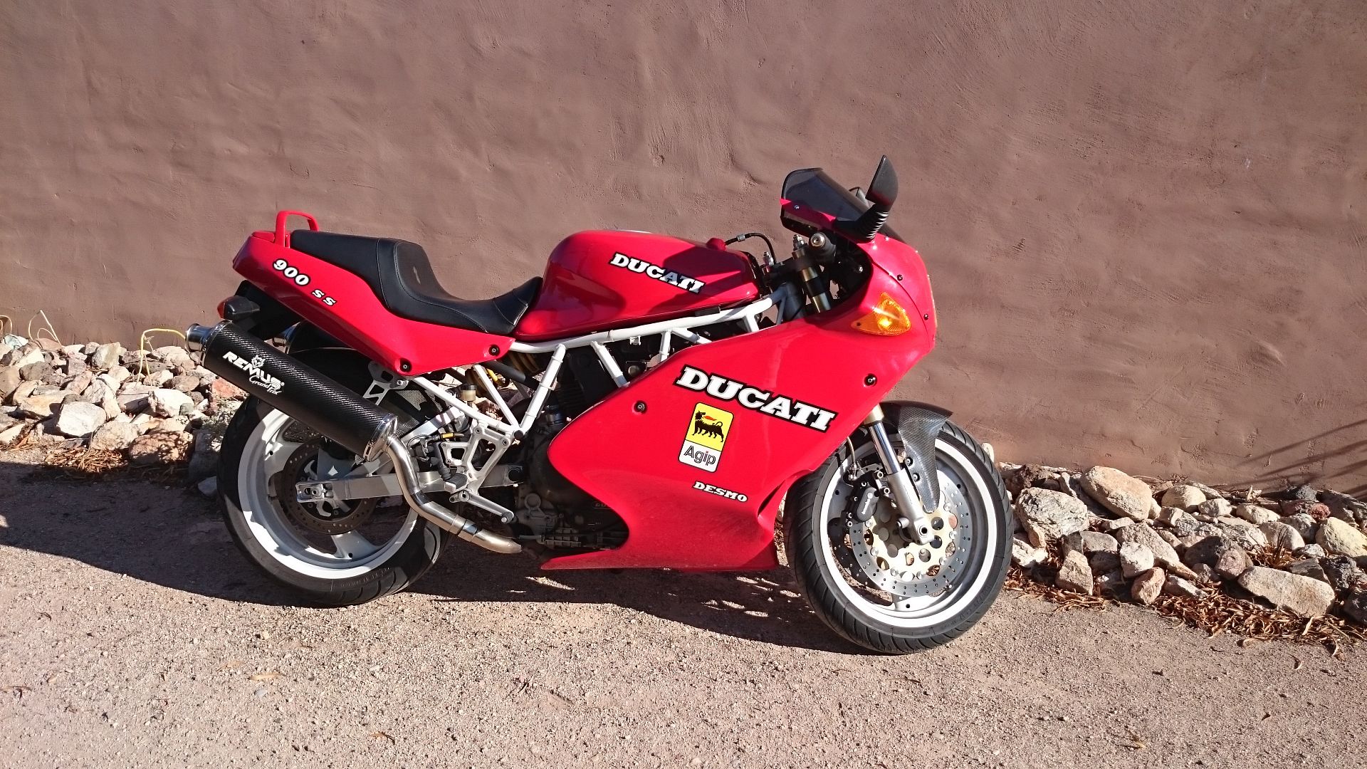

I think the original full fairing looks good, fortunately I now have two of these so I'd like to take this naked bike look a little further for now.
Here is the other one.

Call me crazy I always liked the early white frame/wheels and early font decals.
Totally agree - I´m (supposed to be) retromodding my cracked frame & swing-arm, worn out & abused ´97 into a 1992 lookalike - though I´m not going for white wheels as they are a total pita to keep clean
