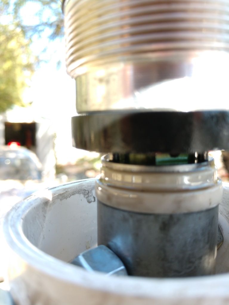

Pulled the right fork off today and disassembled. To my eye, it didn't look like the manual or any of the videos on the process. Had an anodized green bit that fits the 17mm wrench at the top that had three pins poking into a single metal washer - the manual mentioned a whole lot more "washers" that weren't there. It was very clean, but I knew the fork oil was at least three years old and possibly as much as 11 so I am glad I did it - it was roughly about half the 440cc that were supposed to be in there. Funny thing, the left one does not have the allen bolt at the very bottom of the fork (for the rebound rod?)- is that normal? I will refresh the oil in the left one this week, but to be honest the forks handle great right now,... would like to clear up why the left one is different before I take it apart.
Perhaps I will regret it, but I did not replace the oil seal while I was in there, it has shown no sign of leaking in 60 miles so maybe it is alright.

Both legs come apart the same unless someone changed something. Remember the left side has the threaded axle adapter you need to remove first to access the damper assembly bolt.

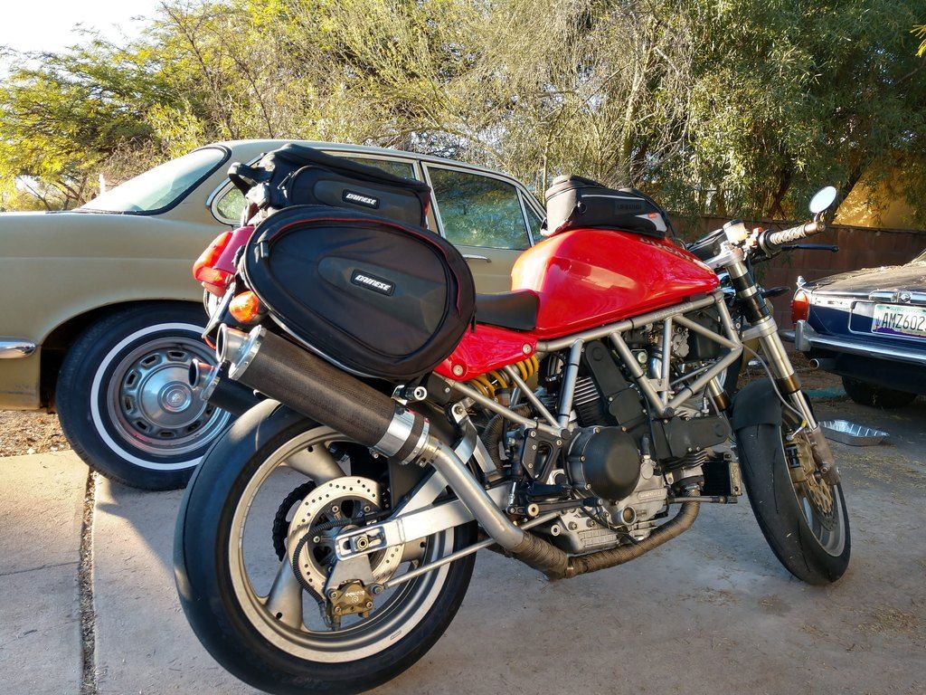

I also would be wary of the brake line routing at the caliper shown in the picture, the line should be pointing up not forward looks like the wrong lines fitted and that could lead to a line failure. Test them fully through travel to make sure the line is not going to pull out or get pushed into the wheel/tire and ripped off.

Ah-Ha! Yes, the left one does have that threaded insert, that's the explanation, thanks.
I did move the brake line after a quick test ride, the cabling is really tricky behind the speedo with all the relocation of the wiring and I was focused more on that.
