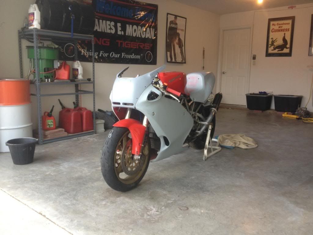

Its been a couple weeks since I posted any progress, because progress has been slow I got the brake line on and bleed, had the suspension set up by a local suspension genie and finished up the dash. Got my race front fairing in last week and fitted the bodywork. Decided on a paint scheme last night and laid the paint down on the side fairings, will do the nose and tail tomorrow!
Now for some pics...
The dash is done, aside from a ducati decal or two:
The body work mounted:
The layout of the front number plate, I have a similar one on my 916, I dig the one sided look:
Finally the paint on one of the side fairings, design stolen from the D16rr:

Thanks for the help Joe, thats how I routed mine so I guess its right!
Got the fairings painted and wet sanded. Had to mount them up to get an idea of what its going to look like
