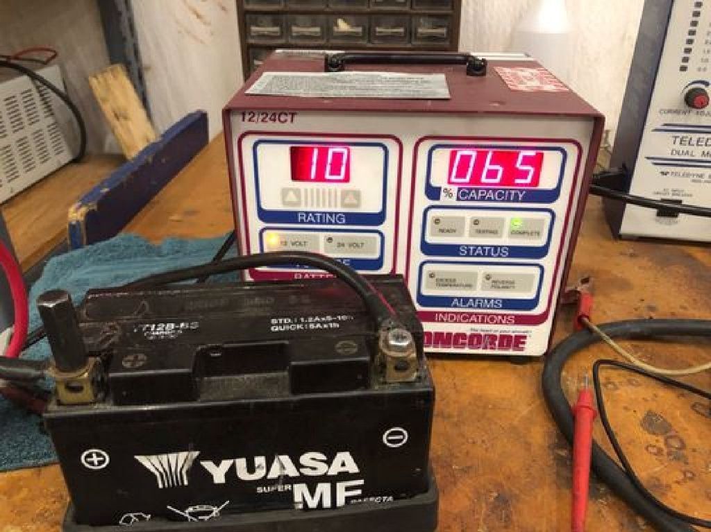

post #7 of 7 (permalink) Old Jul 18th, 2019, 9:37 am
Buhgaboo's Avatar
Join Date: Jul 2014
Location: Greenville, SC, USA
Posts: 279
Originally Posted by duc96cr View Post
I ordered a new battery. Whatever else might be wrong, the battery isnít checking out. I put the battery on a desulfurization mode, but Iíve never had luck with that in the past. The first thing I did was clean the grounds, but according to the schematic the main battery ground goes to the back of the engine ( cleaned it) and there is a pigtail at the battery ground for ecu and everything else. I cleaned the connectors. If a new battery doesnít fix it Iíll make a new pigtail and run it directly to the ground terminal. My son says all the electrical issues Iím seeing could just be a bad battery, and heís far more educated in vehicle electronics than I am. Iím just curious about the battery itself; How could it check between 12.6-13.13 every time I checked it and not even make the new solenoid click or the ecu work. It just seems crazy.
It's the batteries capacity that needs to be checked...my 4yr old battery still held 13+ volts but it's amperage was down...did a low volt charge spanning a week but never got above a 65% capacity... chemistry is chemistry...the anode and cathodes carrode or get coated acidity varies...umpf gets diminished...bottom line volts tell only part of the story
