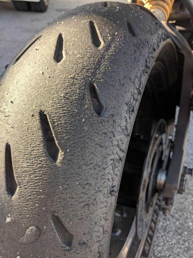

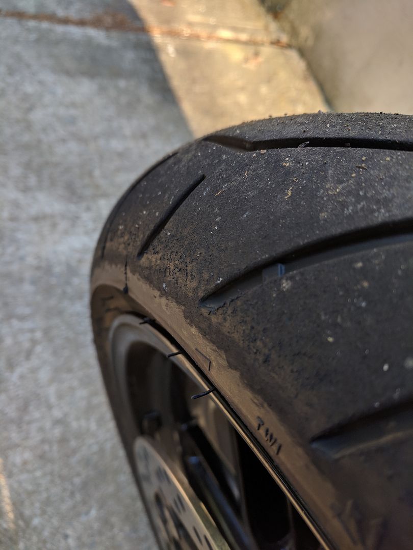

I'm sure everyone's experience is going to be different and I'm sure I'm on the low end of longevity for any tire given my surroundings...I'm on a set of rosso2 right now (came new with the rims)...I'm nearly to the wear bar with only 1k miles in... rosso2 have a far smaller 2nd compound than the 3...the 3 center compound is great and very long wearing...but the side compound just disappeared on me ...i would surmise that I was running the wrong pressure on the 3s but I have been diligently adjusting the rosso2s and I'm near done with them...the wear has been so bad it would be hard to get me back on them...that said the rosso3 is very flickable and far better in the rain when it gets aggressive...the second compound on the RS has zero silica and didnt like anything north of 28psi...
I'm frugal... I try and get my money's worth...when one area wears before another I feel I've wasted my money...with the rosso2 I would roll off the throttle to preserve the center...had no issue with that on the 3....I still had plenty left on top in the end but no performance left at lean...
Here's how I like to roll...
That's some even wear...vroom vroom
