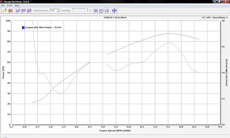

87,6 HP on the dyno - AF ratio not good
I am satisfied from the total horse power but it seems I definitely must go for power commander and adjustment. Hyper with 16900 km. pods (the ones came with the HM 69 tank), Zard headers, Termi slip ons and the DP ECU.
All comments are welcome. Any e-shop with discount price on the PC III usb?

that A/F graph is scary.

Very!

Do you thing I can adjust DP ECU and fix the problem or the only solution is Power Commander?

You'll need something to trim/add fuel at given RPM increments.

The oem ECU should have an idle trim adjustment in software. You are far too lean at low speeds. Is this a closed loop system?

As I mention above I have the DP ECU came with the Termi slip ons. Also Zard headers and pod-filters (no airbox).
I really like to avoid power commander (not only for the extra €500 for purchase and labor). I will discuss this later today with my mechanic but
your opinion is appreciated

Try checking with TomTom at Hypertrick. He can probably reflash your ECU
www.hypertrick.net
I yhink he can do the Hyper even if its not listed. Good price since you dont need a PC3 for the bike.

After discussing with my Ducati service but also with the owner of a motorcycle e-magazine which I trust ( http://www.ebike.gr/ ) I will adjust the DP ECU and hopefully AF rate will look better
I will do this tomorrow and will check again results on the same dyno

You are not going to be able to fix that by adjusting the trim.
