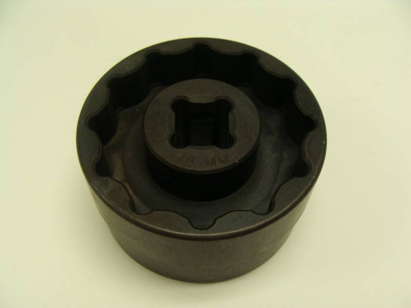

This low profile socket stays on the wheel nut alot better than tall sockets:
CORSE DYNAMICS Wheel Nut Socket
41mm on one side and 46mm on the other-This dual sided tool was specifically designed to work with OEM Ducati nuts, billet aftermarket nuts, Titanium Nuts, 6 point Nuts, or 12 point Nuts. This is the only steel tool on the market that has been made to work with all nuts on the market.

this is the best one!!!
i use motoMFG , there are a site sponsor and have the best customer service.
they sell a double sided( one side for the wheel and one side for the sprocket) socket made out of steel and its six sided. you can also get 10% off as a forum member.
six sided is better then 12 sided as it puts more force on the flat part of the nut and not the corners.
as far as there service ,its top notch. i had there first batch of aluminum ones and it started to round out just a hair where the breaker bar goes into, i sent them a email asking what can be done and they sent me the new steel one for free the very next day and paid the shipping. thats called perfect customer service, doesn't get better then that. i have bought two other things from them after that just because of how they treat there customers.
+ 1 i've got this one and you can use it one handed while holding the back brake on, stays on the nut nicely. i use a ratchet handle which extends to 60cm, 2 foot roughly to undo the nut, you wouldn't use a tension wrench to undo it of course, and you need a tension wrench that goes to at least 130ft/pounds to do up the right hand side nut. it also works well with a compressor and impact gun

On the cheap sockets grind the rounded surface flat so it looks like the pictured ones , if you got some extra room line the socket with some electrical tape , AND BE CAREFUL , sos it don't slip off .
I find a good quicker bounce on the extention handle rather than a slow increase of torque works better, Be prepared for the release and you will be OK.
