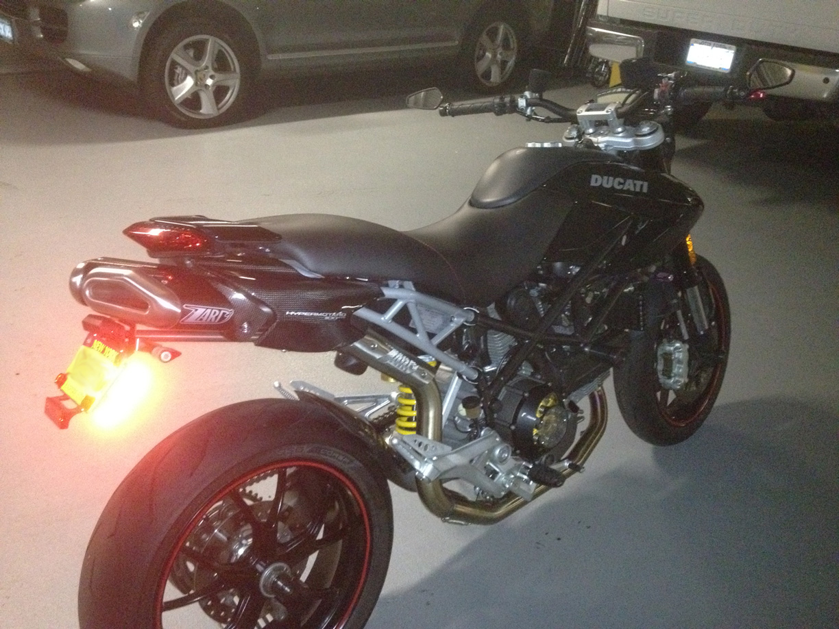

Ok, explosions may be a bit of an exaggeration but it sure sounds like it. This isn't your usual popping but rather ear deafening bombs when going from say half open to closed throttle.
I just finished installing a full zard penta exhaust with the MWR full lid airbox replacement and an ecu reflash from Proitalia on my 2010 EVO.
I don't necessarily mind the noise as it sure does get the attention of the usually oblivious cattle walking the streets of NYC but I am worried that it is running WAY too rich. Should I be worried? Is this doing any damage to the engine? The brand new headers are already a deep blue/purple from the intense(r) heat.
Should I invest in a PCV as the reflash now made the ecu an open loop?
Attached is a pic of the her all set up.
