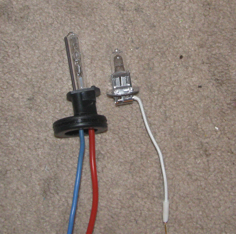

I just did an HID-ectomy
I bought a used ST4s that the previous owner had put HID's on.
Nice clean install. All the wires and stuff were all tucked away nicely.
Problem was I couldn't see $#@& with them on.
All I saw was a small crescent in front of my bike with no fill.
On comming drivers would flash me like I had my high beams on.
Here is a bicture of the correct bulb next to the HID I took out. kind of shows why they don't work. The light is nowhere near the focus of the reflector.
