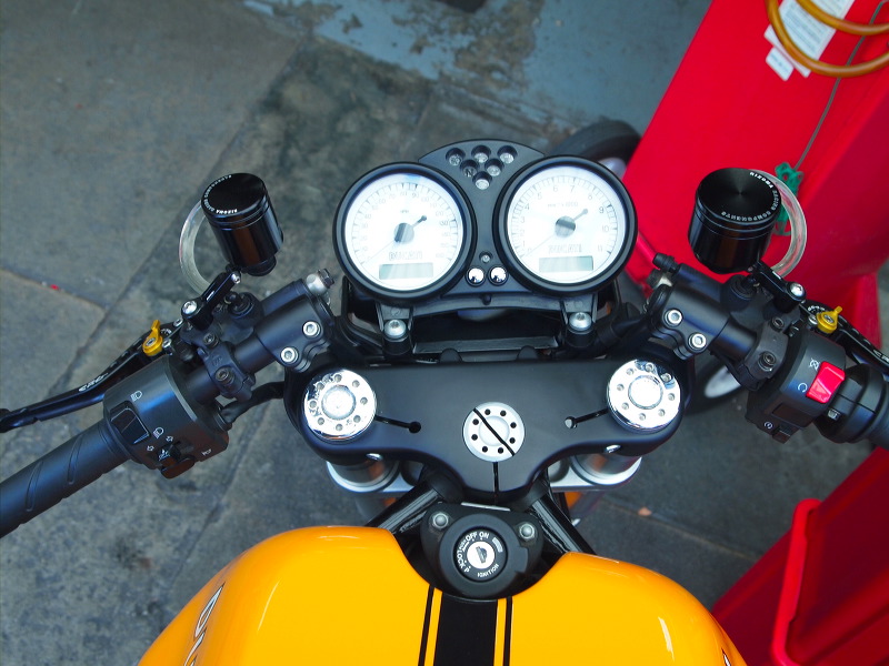

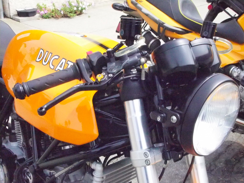

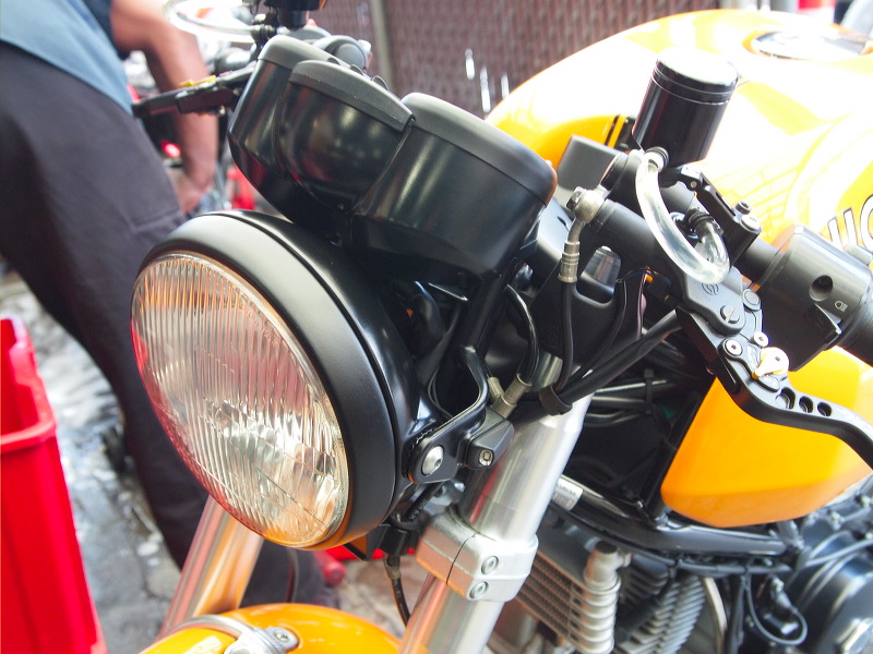

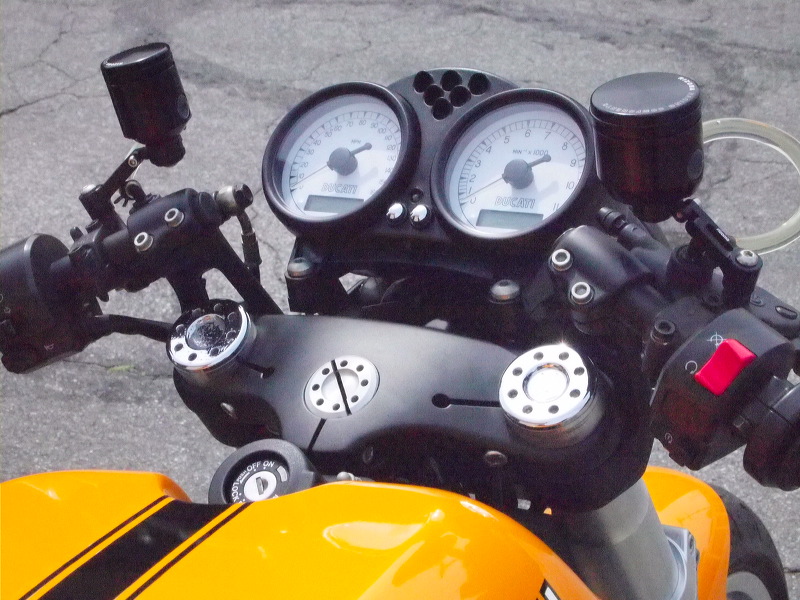

A little Anodizing and a little powder coating
Can you tell which is Which?

Triple and headlight bezel anodized and H bracket powdercoated?
Looks great BTW going the same direction with mine

Reservoirs and levers anodized, the rest powdercoated. Too bad the "U" bracket couldn't be powdercoated with invisible.

Bars, clipons, headlight mount bracket, are Hard Anodized
the Headlight bucket, bezel, headlight bracket and Dash Ring are Powder Coated
Tanks and levers came anodized
